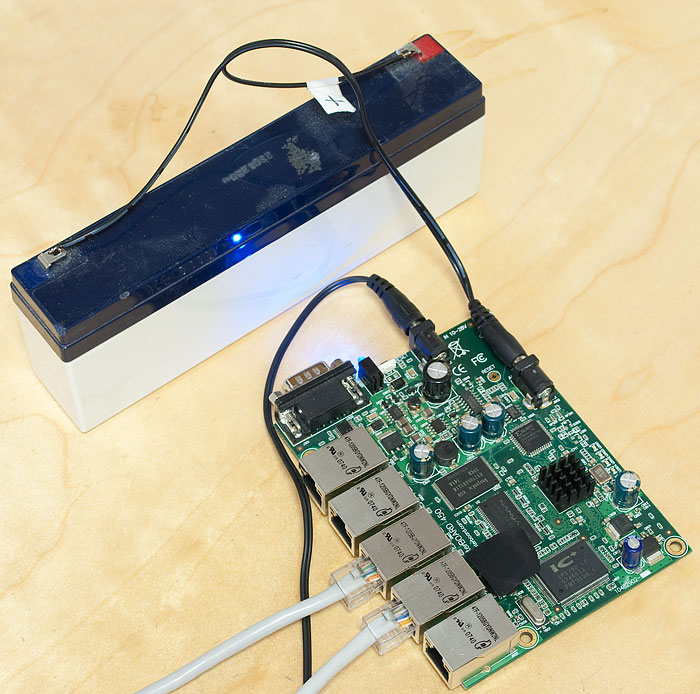

There is more than one way how to use the two power jacks on RB450 (the obvious one being - if you use another type of enclosure, and don’t want a wire in the front).
This creative example shows a battery attached to one of the jacks. The jacks are connected. As this jack receives less voltage, so it’s charging the battery, and board is powered from the powered jack. If that jack would be removed, the battery would kick in.
Batteries that can be used are 12V from 1-5Ah. PSU switching adapters are recommended 13-13.8V so that they can charge these batteries. The battery in the picture is lead-acid jelly type. From this 2.2Ah battery, this device will work around 2 hours at full load.
