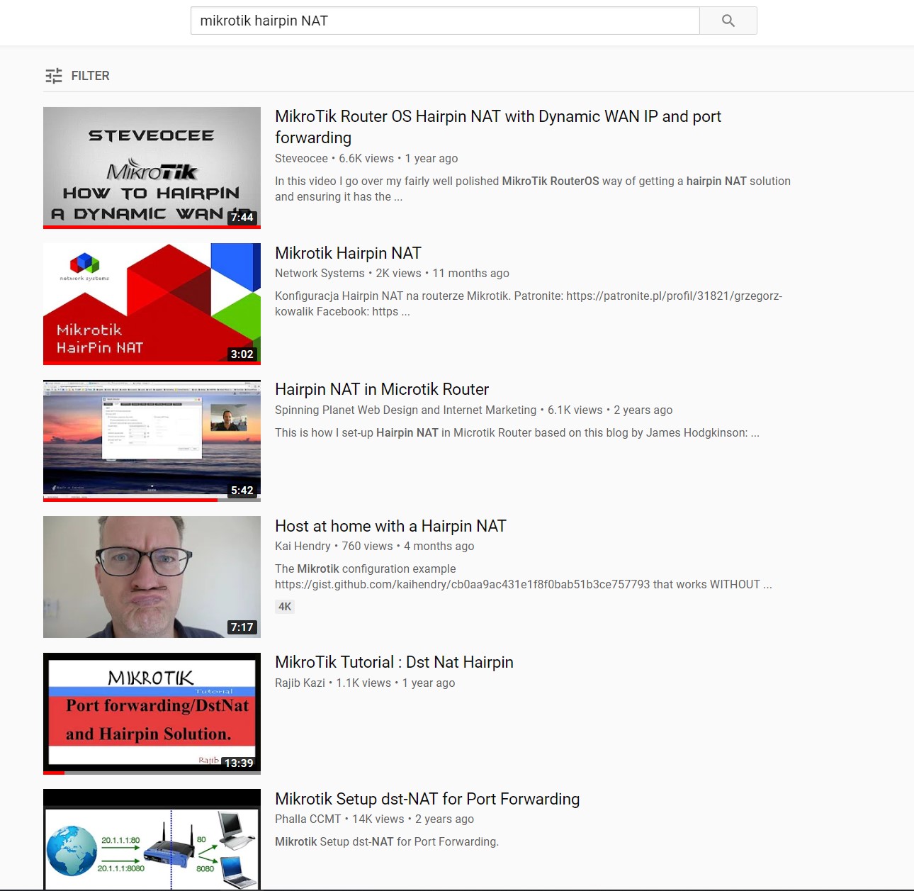

Example video:
https://www.youtube.com/watch?v=_kw_bQyX-3U

Firstly, thank you for linking my video :sunglasses:
I use home.mydomain.com for getting into certain things remotely and from home. These are differentiated by port number. I can’t do that with internal DNS so it suits me quite well. I shared what I found as I initially had a lot of problems getting a hairpin NAT to work.
The post by thirdstreetzero is another prime example of why I love MikroTik so much. There are multiple ways of doing the same task, there is nothing to say who is correct or who is not or even who is more correct. Take a look at the comments in my video, there are a lot of people who have identified the need for a solution for the niche problem and have been very successful following my advice.
The bit about going round the block I don’t fully agree with, ultimately the client needs to get somewhere so it queries the router where to go, router either says go down this cable it’s on my LAN or it says goes down this cable it’s on my LAN. I understand where the comment is coming from and why and can vouch for it never having caused me any queuing problems, mangling problems, security issues or even fasttrack problems.
Each to their own but if it triggers people so much that their solution is better because mine is not needed then maybe they should help others with that knowledge, make a YT video, title it MikroTik Hairpin NAT and then supersede me at the top of the search list? (That comment isn’t intended as being arrogant although it may read that way).
