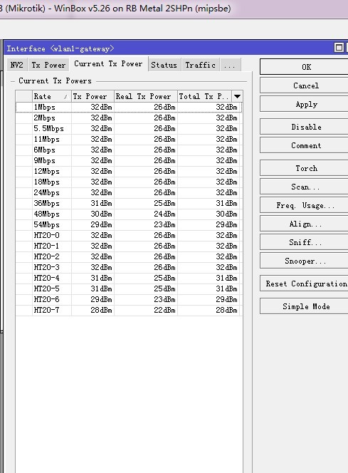

why RB Metal 2SHPn real tx power max on 26db?
RB Metal 2SHPn have 1.6w tx power.
why show real tx power 26db max?and tx power > real tx power

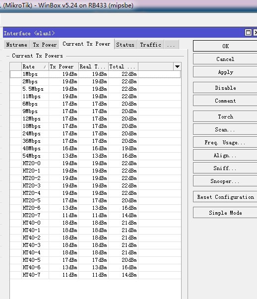

my rb433 show 19db real tx power.and tx power = real tx power

if i change tx power at 17db.tx power - real tx power = 6
if i change tx power at default.tx power - real tx power = 6
why RB Metal 2SHPn always tx power - real tx power = 6db? but rb433 tx power = real tx power

Real TX power means specified in the wireless chipset, Total is the Actual power you need to be looking at. The signal is amplified, that’s why the EEPROM value an the Total value are different.
It sounds misleading, but you should be looking at the “Total” as what you get.
oh,i see your mean!
the wireless card tx power at 26db max,and signal is amplified always have 6db?
