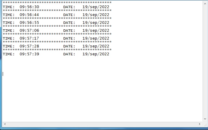

Thanks REX, in the file write like this.
But I would like you to write like this, of course if you can.
EL DONCITO.

Check yourself what you done wrong,
for me work:
TIME: 01:00:10 DATE: 02/jan/1970
TIME: 00:59:57 DATE: 02/jan/1970
TIME: 00:59:44 DATE: 02/jan/1970
The script is working very well friend Rex, how can I send the file before it reaches 4095 bits by mail
EL DONCITO.
