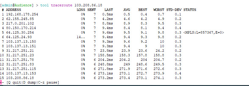

Why tool traceroute limited to 14 hops?
Why
New Terminal > tool traceroute host
limited to 14 hops?

In the case where you thought it was limited to 14 hops, were the last 5 timeouts too?
You add max-hops=30 if you want to go that far. Maybe after 5 timeouts it auto stops, don’t know.
That’s where I was going too…
Yes
Then I think you have your answer, it probably doesn’t go beyond 5 timeout lines.

you can play with max-hops=x
