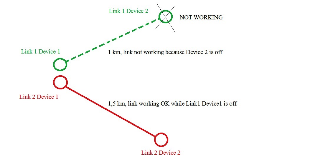

They are connected from one site to diferent directions like in picture:
Now:
Link 2 (red) is link that has worked normally before installing Link1 (green).
Device 2 of link 1 is turned off.
When Device 1 of Link 1 (green) is turned on I have problem with link 2.

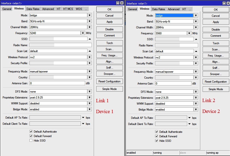

Here are configurations of both Bridge sides (Device 1’s in the middle).
NOTE: It should be Link2 Device1 on right picture
First I had them on 60 MHz distance but I had problems. I put them on 5560 and 5240 (just for test), and sam thing happens:
I had problem with link 2 and it constantly losing connection.

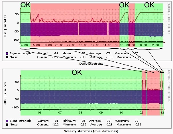

I can show you graph for over time, just to see visually. I upload daily and Weekly graph. Red square is OK (follow brown line on top of the graph in Weekly graph), and after installing Link1 problems appear. After turning off Link1 Device1 (Device2 is off all the time) Connection is OK (I’ve tried few times, see on graph).
What can cause this interference on different channels?

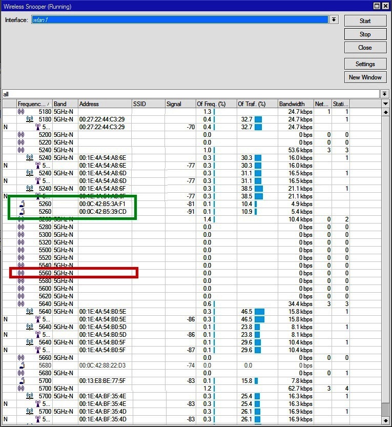

Can you post your wireless scan with both radio’s on from both units.

Hi n21roadie. Here it is, although I use free spectar (if you think that’s because of some other station).
Red is mine problematic link (5560). Green is my other link that interfere.
Hi Mark. Unfortunally I don’t have power at that site (link 2/device 1) so I can not switch it on.
But as I see, problem is regardless that link (just depending on Device 1). Probably would be same situation.
