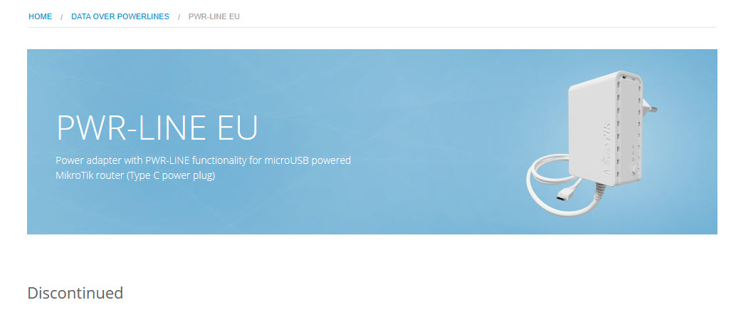

Have they actually been discontinued?

Product page seems to indicate they are.
LOL ,fair enough – I must have looked at the US one (despite the subject line here) – why US isn’t discontinued, dunno.
