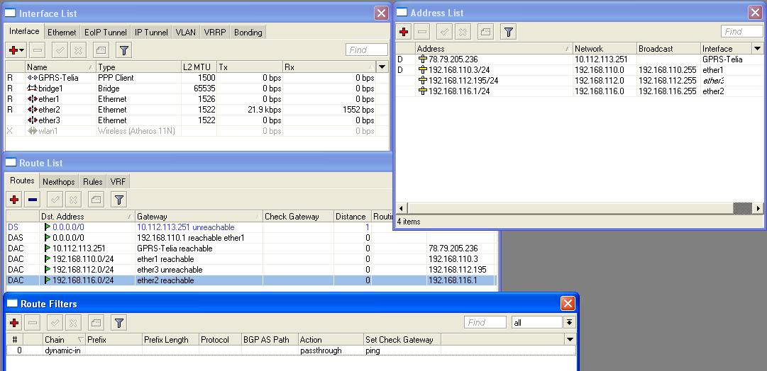

Now I tried, but unfortunately I cannot get it to work.
If I unplug my wired internet from my RouterBoard, the dynamic route gets inactive and my 3G route becomes the active one.
Conclusion: When the RB looses the ehternet link it reacts by changeing route.
I have my RB connected via a switch to my ISP. If I unplug the cable between the switch and the ISP, the RB still sees a link, but shouldn’t be able to ping the gateway. In this case, the RB does not react by changeing active default route, even though I have the
/routing filter
chain=dynamic-in protocol=“” invert-match=no action=passthrough set-check-gateway=ping
/Per
it should work. if you double click on the dynamic route does it show its using check-gateway now? Maybe that routing filter isn’t being applied properly.
No, the check-ping is empty in the default route !!!
/Per
weird. which version of routeros?
can you post:
/ip route print terse where dynamic dst-address=0.0.0.0/0
and
/routing filters export
Sam
 0 ADS  dst-address=0.0.0.0/0 gateway=192.168.110.1 gateway-status=192.168.110.1 reachable ether1 distance=0 scope=30 target-scope=10
 1  DS  dst-address=0.0.0.0/0 gateway=10.112.113.251 gateway-status=10.112.113.251 reachable GPRS-Telia distance=1 scope=30 target-scope=10
[admin@SevenAcreRemoteRoute] > /routing filter export
# feb/09/2011 06:55:35 by RouterOS 4.13
# software id = 7WYN-I37Q
/routing filter
add action=passthrough chain=dynamic-in comment="" disabled=no invert-match=no protocol="" set-check-gateway=ping

Hi.
I realized that i had the protocol=“” specified.
If I remove that part (disabling the protocols in WinBox) the default routes get the check-gateway set to “ping” .
When I now disable connection to my wired internet, the route gets inactive after a short vile,
BUT my alternate route to internet (through 3G) never gets the Active flag.
How come?
/Per
