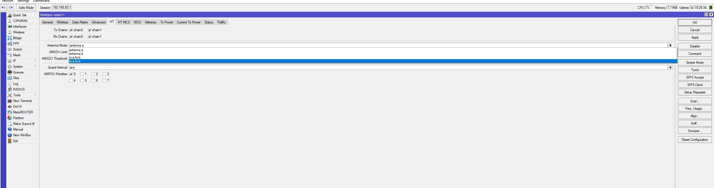

I don’t see a “chain” field on it
But in Winbox gui on the “HT” tab I marked both “chain” ( I am attaching a screenshot_1 )
I also don’t have “default” choice in “Antenna mode” field ( I am attaching a screenshot_1 )
And I tested all 4 available modes, the situation has not changed

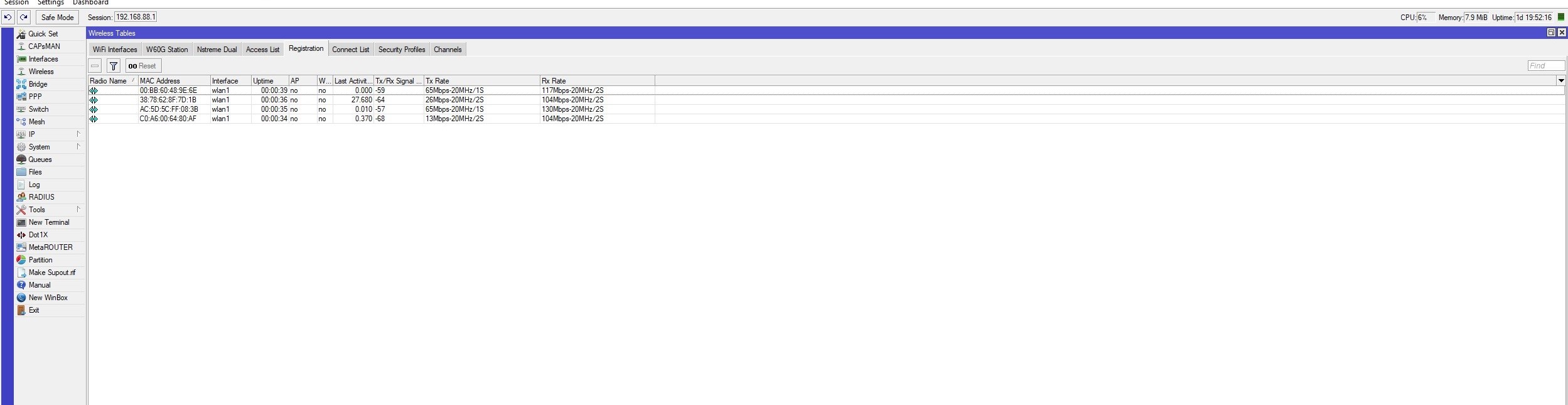

BTW, when device is just connected, in “Registration” table I can see something like “26 Mbps-20Mhz/2S” but then it became 65Mbps in 1S ( I am attaching an example on screenshot_2 )
Your AP has the full 2x2 (2S) capability correctly configured and it is used. The “interface rate selector” selects the interface rate it can work in. The top is MCS15 (actually 2X2 MCS7) , one step lower is MCS14 (2X2 MCS6) … if there are still problems in transmitting a packet the “interface rate selector” will step further down. The algoritm is brand dependend. Also if one of the chains is weak then only 1S can be choosen. The registration screen (if you select ‘detail mode’ in the right down arrow) will show the signal strength per channel, and many more. A low CCQ will make the rate selector step down, a good CCQ will make it step up. (That step up/down process can be unstable). The number of retransmits can be calculated from RX and TX packets versus RX and TX HW packets. That is how CCQ and P-throughput is calculated.
If the connection drops to 1S, then either the signal has become too weak, or there are so many reflections, refractions, scattering and interference of the signal that the receiver cannot separate the 2 streams.
To have the registration information as text ,you can use the CLI command
“interface wireless registration print stats”
