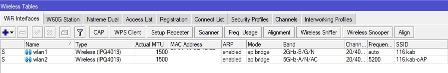

Those are broadcasting at two frequencies at 2,4 Ghz and 5 Ghz with two separate Wi-fi points.

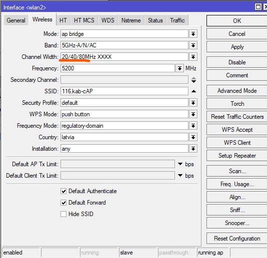

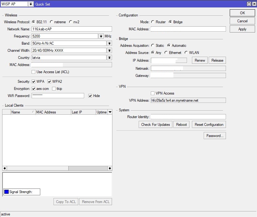

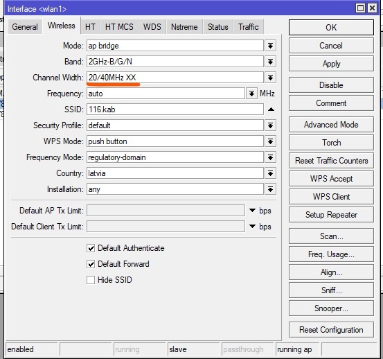

I would limit your width to max 40MHz on 5Ghz, 20MHz on 2.4GHz.
Maybe even go for 20/10 … maximum 100Mbps/50Mbps speed should be more then enough for a Chromebook.
Don’t use WPA unless you really must. It’s slower then WPA2.
2.4GHz: don’t use auto. See which frequency is the least used and set it manually.
2.4GHz, only use 802.11n if possible, b/g makes things slower.
