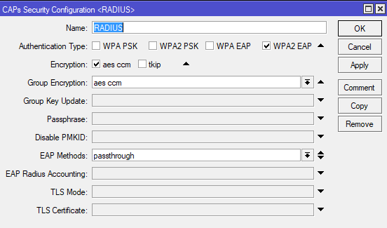

  • The security setting is as follows

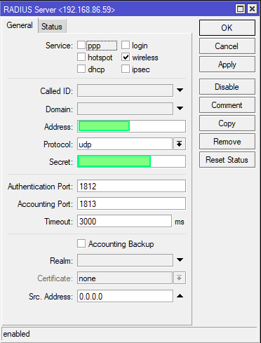

  • The setting for RADIUS is as follow
Radius works as evidenced by the following status screen

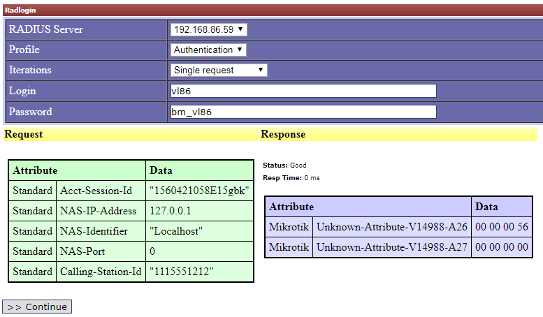

I did a test with radlogin (radius test client) from another pc and this is the result:
Is that response acceptable? I am assuming it is the test client that is unaware what those two attributes are.
