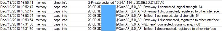

As an example, I have 5 AP’s setup in my own home (5x wAP AC) with a CCR1009 as my main router which runs CAPsMAN. All traffic comes in from whatever AP I’m connected to and even when downloading and running around the house and grounds, I always stay connected and something like a download keeps running without an issue. CAPsMAN in the logs clearly shows I’m hopping between AP’s but all sessions stay alive without issue.
I’ve included what the central CAPsMAN router shows in the logs and where you can see how my phone connects to whatever AP is best at that time.
