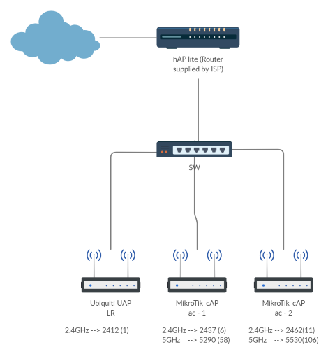

The topology of my network is as follows:

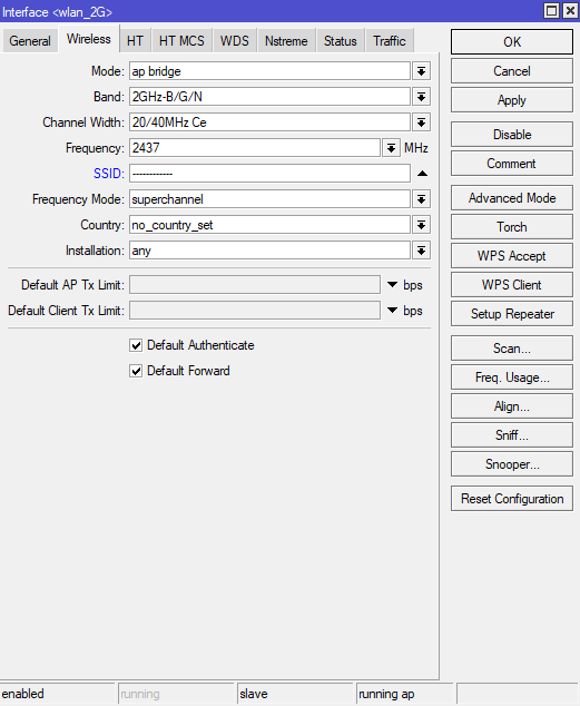

And the Wireless configuration on both devices:
2.4ghz configuration

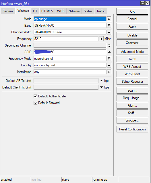

5ghz configuration:

The 2.4G band is subject to interference, especially if you use 40MHz bandwidth. Only use 20MHz bandwidth and channel 1, 6 or 11 (as being the only non overlapping channels with this width).
Set country and Frequency mode to regularity-domain. And don’t use 802.11B…unless you have a really ancient device that only support B.
For 5G band: Set country and Frequency mode to regularity-domain. For 80MHz channel width only use channels: 5180 (36), 5260 (52), 5500 (100), 5580 (116), 5660 (132) or 5745 (149) depending on country code. If you choose a DFS channel it might take up to 10 minutes before the SSID is visible.
