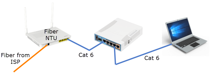

As to what my network looks like…
It’s just a fiber NTU (Huawei HG8045H) connected to the MikroTik RB962UiGS-5HacT2HnT.
I have no netgear equipment. Think they are coming in via the Fiber NTU. Which is concerning as that means the network is not secure on the ISP side. Not sure if this is normal…
OK, now I finally start understanding - the NTU is in bridge mode, so the PPPoE client runs on the Mikrotik, but you can see a lot of DHCP traffic to arrive to the Mikrotik from the WAN side as the ISP’s network allows IP traffic to pass between the core and the NTUs (which is indeed a security issue among other things).
