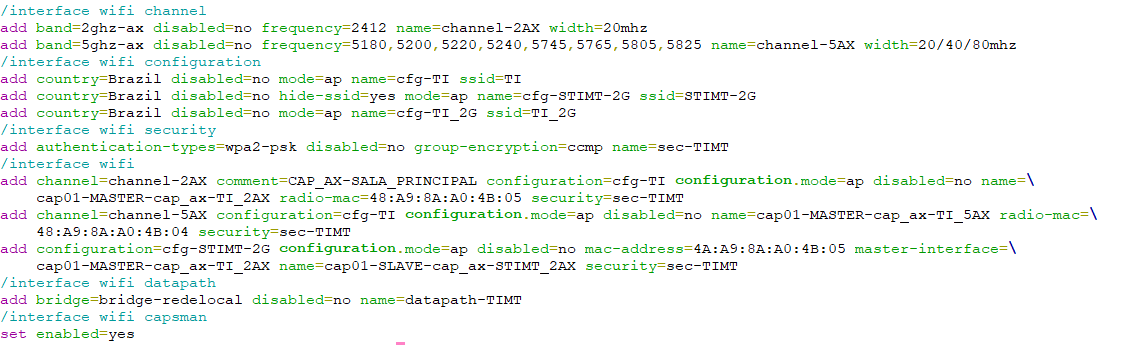

I’m using a CAPAX in version 7.15.3 with capsman active on a CCR1036 in version 7.15, I’m having problems connecting my devices to the 5G channel, when I activate FT or activate FT over DS my devices even switch between 2.4ghz and 5ghz but they keep falling every 10s and don’t stop switching, when I disable my devices they simply don’t connect to the 5ghz network.I have already tested using wpa-psk and wpa2-psk without ccmp and I had no positive results.
the print below is my last configuration attempt
Could you also show the provisioning?
https://help.mikrotik.com/docs/display/ROS/WiFi#WiFi-CAPsMANProvisioning
