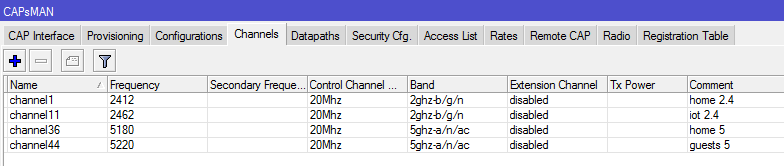

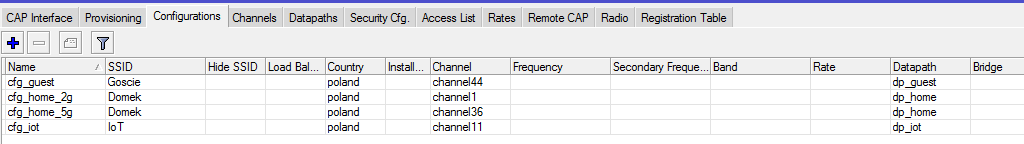

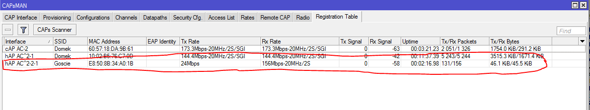

hAP AC2 is my main router on which wifi worked at full speed until it was configured “localy” (in wireless instead of capsman). In order to extend wifi range I bought cAP AC. There was some mess with configuration, because of my three vlans and multiple ssid, but I finally managed it. Everything is working fine, but I noticed that connection speed on all of my 5g devices went down from 7xx mpbs (I think it was 733 but not sure) to 130-170). Doesn’t matter if I am standing 1m from hAP or cAP and I connect to guests network which only operate on 5g and it shows me 1xx mbps speed. I think it has to do something with channel setup (when hAP was alone, channels were set to auto, but I dont see such option in capsman) but I tried to change everything and it doesn’t help. Samsung galaxy phone is marked red in registration table, it used to have full ac speed.

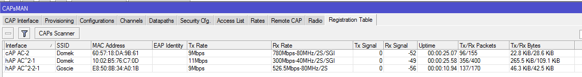

Are you talking about throughput or connected rates?
Connected rates don’t give you too much information when the device is idle. They’re adjusted dynamically based on load and connection quality.

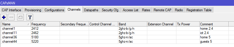

Anyway problem solved, turns out that in MikroTik the best way is to not touch options which You are not sure how works.
I removed “control channel” and “extension channel” and speeds are now ok. Thanks for assistance.
