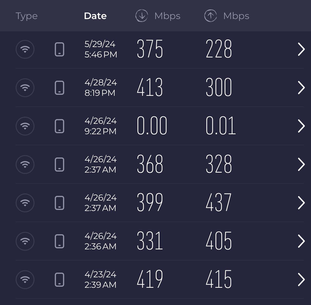

Yes. The image showing 400+Mbps downloads were results from before I put in the Mikrotik router

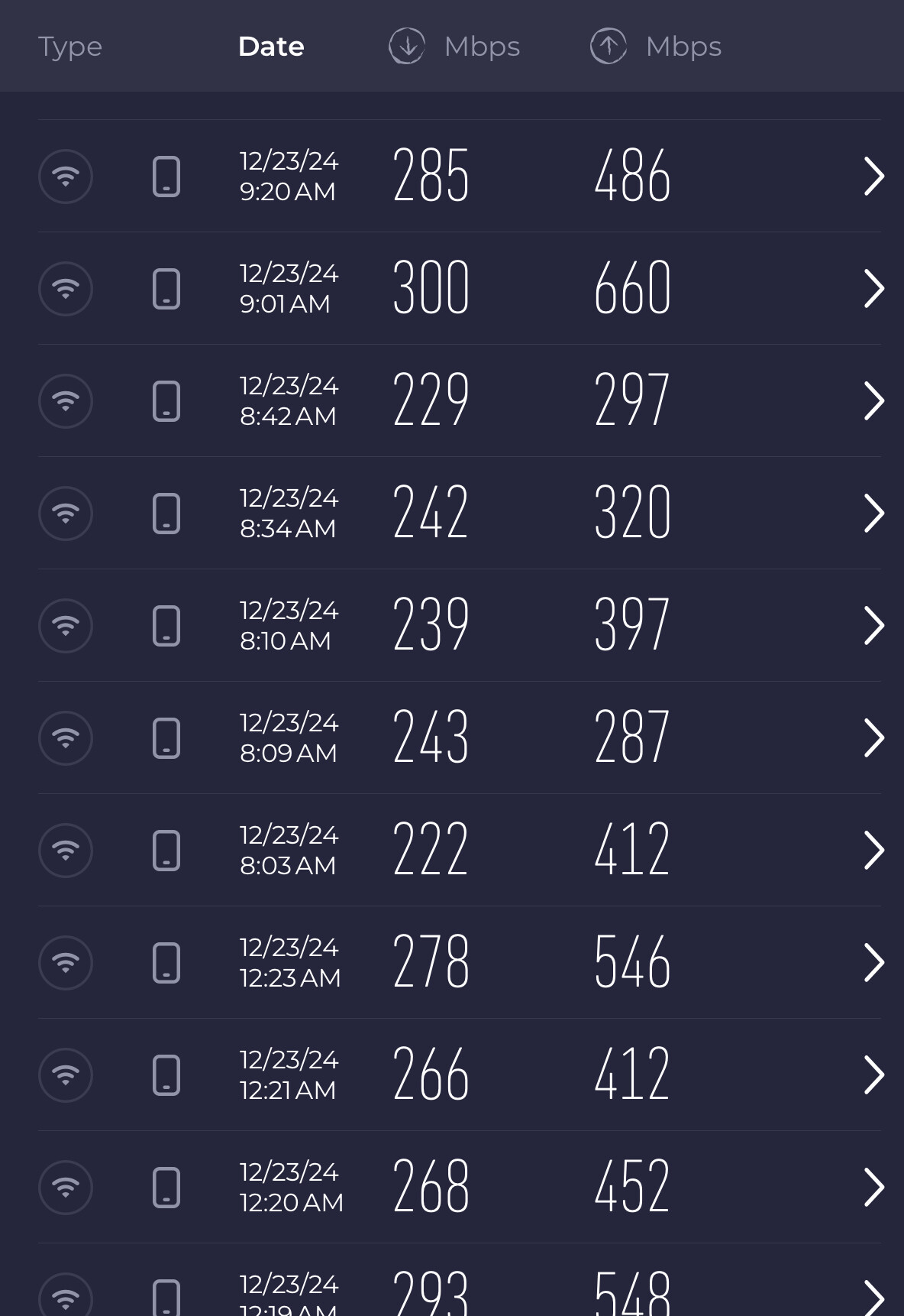

To isolate if this is a problem with the Google Wifi AP, i switched to my old Synology router and set it as an AP behind the Mikrotik router and I got the same exact results.
Getting max throughput when PC is connected directly to the Synology AP but maxes at 300 when connected via WiFi to the Synology AP

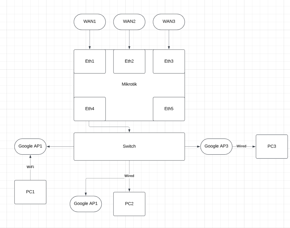

But then we need to see your config AND small diagram how everything is connected.

Please also add drawing how you test your iperf setup.
From which device to which port on Hex, which port from Hex to which other device.
Same with wireless AP, what port is it being connected to ?
Quick comment: this is not a standard config you show here and may very well be the reason why everything slows down …
As an example: using 2 bridges makes sure everything has to pass CPU once you pass bridge boundaries. Bye bye throughput.
Sorry, please let me know if my diagram makes sense.
On SpeedTest i am constantly getting 910-930ish download and 900ish upload on wired connections
Thank you for this diagram.
Where is the iperf server ?
Also, you did not mention in your initial post you have THREE WAN connections to ISP ?
Which device is using which WAN connection ?
Ether5/LAN2 is not being used for the moment ?
Thanks. The 2nd bridge I have was just configured for future expansion in case all goes well in my configuration. This is currently not being used.
The config I have is mainly to utilize Netwatch to handle the multi-wan failover.
There came a time when both WAN1 and WAN2 failed, and we were without internet for a week, so I had to add WAN3 hence the need for a multiwan router.
WAN1 is active for most connections. Im using WAN2 and WAN3 as failovers and not load balancing. I have other IPs configured to the other WANs (different docker containers running speedtest trackers for each WAN connection—they work fine. I get the correct speeds advertised by my ISPs on each connection). Other than that its just WAN1 for everything.
The iPerf3 server is on PC2 and PC1 as the client for the Wireless to Wired test
PC2 as server and PC3 as the client for the wired to wired test
If you are testing from PC1 wireless to PC2, you are not really passing Hex.
It stays on that switch.
What sort of switch is it ?
Simple test since both ether4 and ether5 are on the same bridge:
remove that switch from the mix.
remove/disable bridge2 (to be sure HW offloading is fully active on the remaining bridge) - reboot might be needed, I am not sure here so better be safe and do it.
Add AP1 to ether4
Add PC2 to ether5.
Iperf test. Results ?
Its a basic TPLink 16-port Gigabit switch TL-SG1016.
Noted on this. I’ll test this tonight and report back here.
There are months apart between the results from the two screenshots, over half a year. When is the most recent “good” result (obtained with the old router)? Your wireless environment might have changed in between, maybe the neighbor bought more powerful equipment and now there is more interference? Maybe the Google nodes got some firmware upgrades, or the MacBook some driver upgrades?
