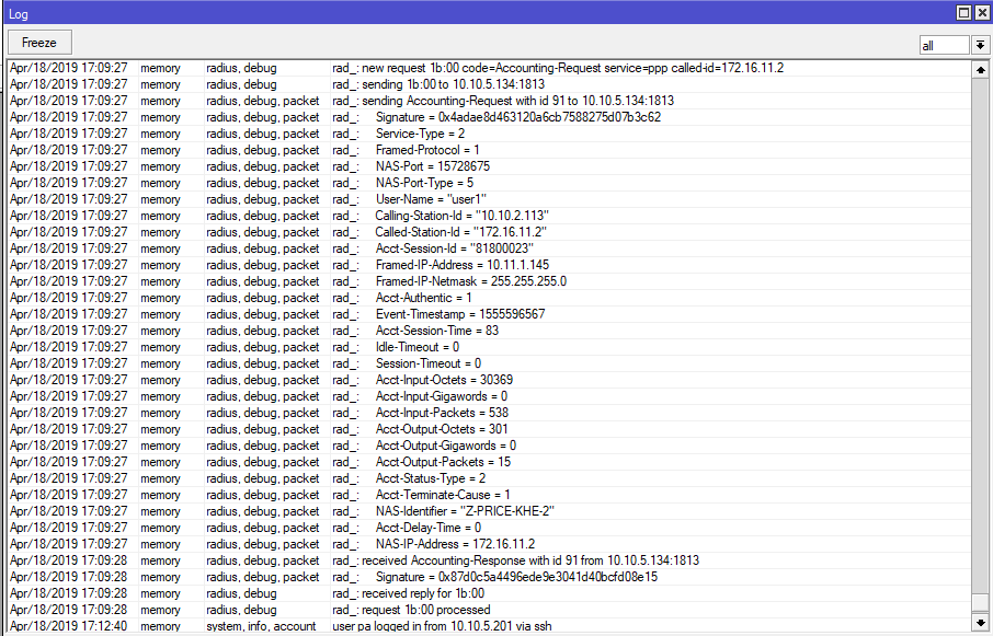

There are screenshots from Mikrotik log, created during I was trying to connect

I’ve tried to add record to radreply table but without result:
INSERT INTO radius.radreply (username, attribute, op, value) VALUES (‘user1’, ‘Mikrotik-Address-List’, ‘:=’, ‘remote_managers’);
After user1 connected to Mikrotik:
there is a record in Log that MT-Address-List=“remote_managers” but it doesn’t appear in Firewall>Address List.
