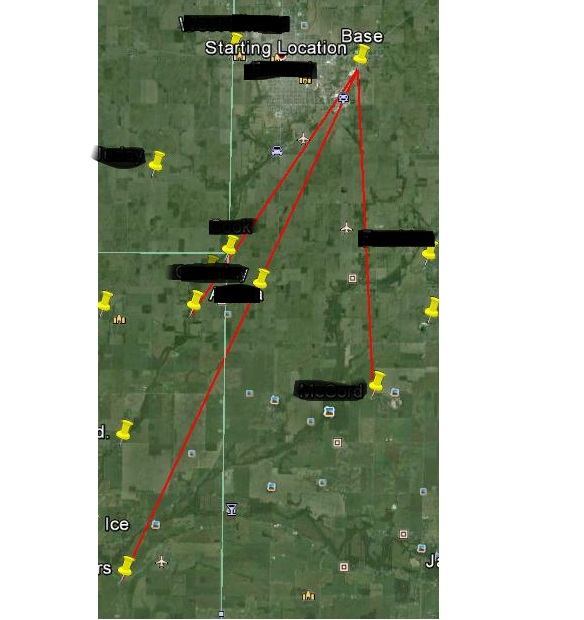

Not much experience with this , but I’m getting some wacky behavior in some links and would like feedback from anyone with any knowledge of this.
I have three backhaul nodes all sending and receiving to the same geographical point. Over the past few weeks the data rates on these links have varied wildly. I’ve used every frequency from 5180 to 5825 Ghz and see no change in behavior. These links have been in place for several years and this has been a real pita lately. They all face a northerly direction and are placed on the horizon about 60 degrees apart from the collection tower. They vary in distance with two being about 6 miles out and the third about 11.5 miles out.
Due north of these paths , from 1 to 5 miles , there is a large wind farm that has been built within the past year . We’ve also had a very wet spring and I’m trying to determine if the windfarm is causing my grief (possible phase cancellation effects) or if it may be fresnel induced losses caused by vegetation growth . Elevation delta from south to north is about 40 ft. the antenna’s are 85 to 100 feet up. I’ve run a spectrum scan ( ubiquiti airview) and see nothing looking north to warrant what I’m experiencing. I’ve also changed cables , bulkhead fittings , radio cards ,and even the antenna feedhorns to no avail. Why won’t my rates stabilize?
