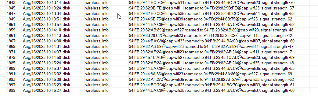

I have clients roaming when still being connected around -50dB.
And yes, everything lower then -70dB I wouldn’t classify as “relatively good signal”
Example from warehouse capsman installation.

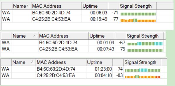

I have configured many Mikrotik wifi devices and maintained them in production environment, so I am aware that not only Tx power is a factor, but also obstacles impacting the link quality (CCQ). If CCQ is high enough then established connection may stay stable even at -80dB, and -75dB then may seem as “good enough”:
If Green is “good” then why not the Orange be “relatively good”, well - “satisfactory”.
However, I don’t have much practice with “same SSID” setups. I had seen “radar” log message, but never seen “roamed” message. I indeed thought that when a connection to AP is established it is maintained until re-transmit threshold is reached. And here is the question - how do we know what is the threshold for MT and especially more - for non MT clients?
I don’t know as well, if scanning for better AP is possible while in a connection, or it is lost - as in initial or manual scan.
I really don’t believe that MT looks at signal power only when taking the decision for roaming. It wouldn’t be nice also, if you loose the connection because of dropping it for scanning, before a better AP was already found. And what means “better” - more powerful or with better CCQ, sometimes they may diverge.
