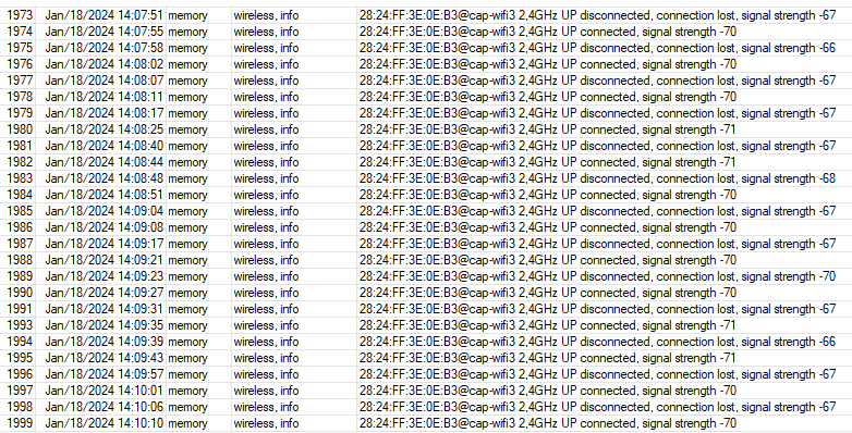

Wifi client DNSA-141 disconnects without obvious reason, prefer AP in longer distance
might have similar issue like described here - http://forum.mikrotik.com/t/wifi-client-disconnects-from-ap-at-relatively-good-signal/168784/1 - but decided to open new thread, as I have some more background info and not sure how to address it. I’m in contact with Mikrotik support for 3 weeks but so far no progress, so let’s see if Community experts could help.

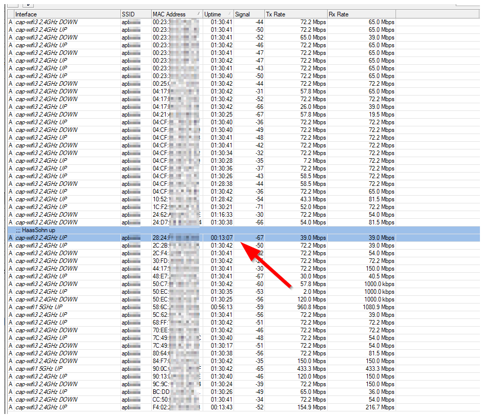

Can you help me to understand why client 28:24:FF:3E:0E:B3 disconnect with signal -66dBm ? This client is based on module DNSA-141 - 2.4GHz - https://downloads.codico.com/misc/Newsletter/2014/DNSA-141.pdf (WLAN module of HaasSohn Kettle). Enabling DEBUG logs do not shows any details. On previous setup with Ubiquity based access points, I didn’t have those problems at all. I have tried all different setting however this combination is required to have all aprox. 53 clients connecting.
Also for some reason, the client 28:24:FF:3E:0E:B3 never connects to MikrotikDOWN, which is actually closer than MikrotikUP, is it maybe some hidden incompatibility ?
After Mikrotik support replied, we found the dependency on enabled AX - as soon as I disable it, client connects even to closer MikrotikDOWN and seems to be more stable but we don’t know why, definitively do not want to get dir of AX. Yet also can’t replace Wifi module in the kettle .

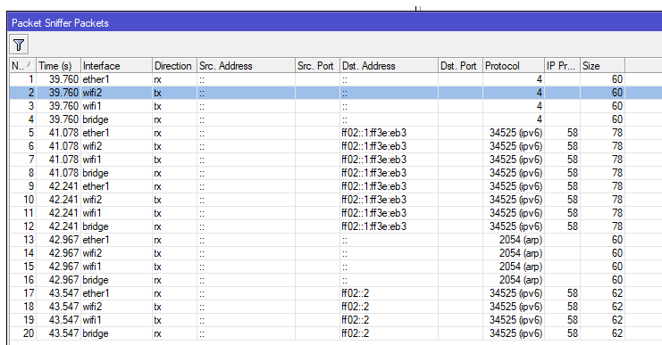

I tried to debug it further, with sniffer I see quite strange behavior :
Why ipv6 broadcast and why it prefer/connect then to AP, which is in bigger distance ? Both APs has the same configuration trough CAPSMAN.
Have you seen anything like that ? Btw also tried different firmware version, including latest beta 8

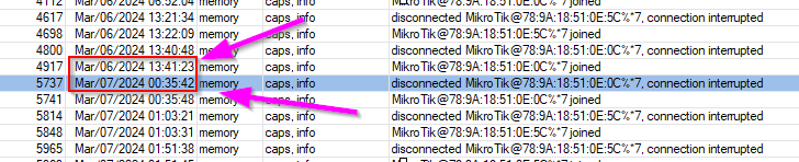

I have key discovery. On 7.15beta4, no improvements BUT - CAPSMANN fails or better to say, start disconnecting after every aprox. 10 hours
When I restart both APs before that time, it’s stable for another 9-10 hours.
