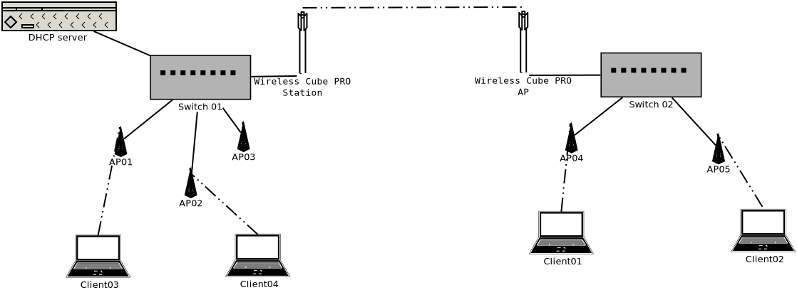

Hi all,
here is my configuration:
where:
  • the bridge between the two wireless cube pro is the PTP tunnel as default from factory (bought the pre-configured pair of devices)
  • AP01-05 are ubiquiti unifi access points that manage 3 wireless networks, each on its own VLAN
Everything was working fine till a power outage (with relevant electrical instability over 60 minutes). After that event Client01 and Client02 see the wireless networks and are authenticated by AP04 and AP05, BUT they don’t receive network configuration from DHCP server anymore. If I manually configure the network on the client, it cannot use it (cannot reach the gateway, ping other hosts, browse internet).
What I tried sofar:
  • plug AP04 to Switch 01: works ok (like AP01, AP02 and AP03). Client04 can use it to connect and use the network.
  • replaced Switch 02 with the one I had before (and that worked with the same APs): Client01 and Client02 can authenticate to the wireless network, but cannot use the network
  • sniffed packets while connecting client01 to wifi network for VLAN tagging:

It seems to me that VLAN tags are preserved.
  • explicitly configured VLANs on the bridge (on both ends) (1 is untagged, 20,40,60 are tagged):
    BRIDGE VLAN-IDS
    0 bridge 1
    1 bridge 20
    40
    60
    –>No change.
So I am out of ideas and looking for help to diagnose and fix this issue.
I’m not sure it’s a problem of the ptp bridge, but the fact that AP04 works correctly if plugged to switch 01 points me to this direction: please be patient if i am OT.
Any hint will be greatly appreciated,
Giuseppe
Well, post the configurations of the two cubes, they should be default or allmost default, the whole "wireless wire" idea is that the set of two cubes should behave as a wire, or as two switches connected by a wire.
You have replaced Switch 02 and tested with AP04 connected to Switch 01.
Have you tried the next step of connecting the original Switch 02 to Switch 01 with a wire, using the same ports used by the Wireless Cube Pro units? Connect AP04 to Switch 02 in that configuration to fully eliminate the Mikrotik parts from the config as a test.
Good idea. I’ll try tomorrow. Thankyou

Today I had finally the time to try. Thanks to your hint I discovered that station network cable had been plugged in a wrong port in switch 01. This port was not configured for VLANs so, obviously, it didn’t allow the VLANs to be used by remote clients :face_with_steam_from_nose:
These power outages are getting smarter day by day, replugging ethernet cables in switches in the wrong ports and stuff
