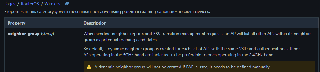

This ?
A dynamic neighbor group will not be created if EAP is used, it needs to be defined manually.
