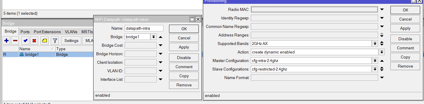

Do you use different bridge or VLAN for each SSID?
I’ve 1 bridge and 1 VLAN (for now). First I would like to have only 2 SSID without VLANs, I would set VLANs later.
I tried to set datapath.bridge=bridge1 for master and slave config, but client keeps disassociated/disconnecting.
What am I messing up?
My problem is solved:
I had to set it up the wifi interface>datapath>bridge option at CAP side.
What is the datapath bridge setting for at CAPsMAN side?
