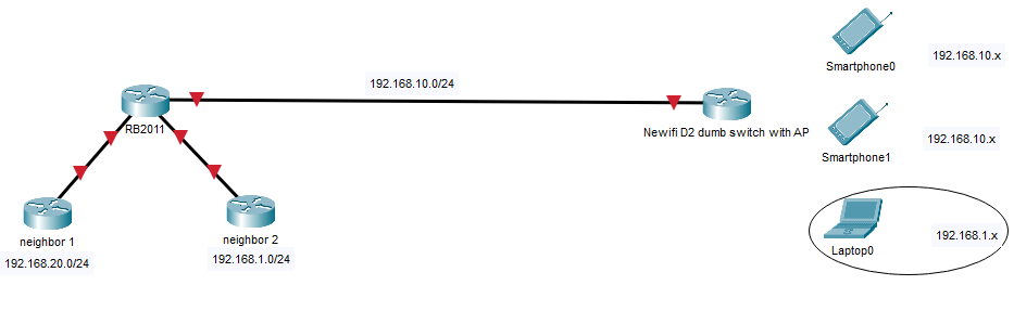

Wifi getting wrong IP
Please help me. I have an RB2011UiAS-2HnD act as my main router after my ISP modem (at my parents house) and a Newifi D2 router (dumb switch with AP) use at my house (200m apart from my parents house and used fiber to connect). In my RB2011UiAS-2HnD, I have 4 subnet, 192.168.1.x, 192.168.10.x, 192.168.20.x and 192.168.40.x.
The 192.168.10.x subnet is extended to my Newifi D2 router (dumb switch with AP). Issue is that a few wireless devices is getting the IP from subnet 192.168.1.x (subnet for my neighbor) and having wifi connectivity issue.
Can help how to mitigate this issue? Other devices is getting correct IP’s and other’s don’t.

It has been a while. Kindly see below the requested my rb2011 config and simple network diagram. On the diagram. like I mentioned before, some of my wireless device is getting the other IP subnet which resulting to unable to browse the internet.

Well the picture says it all, how do you think you will get 192.168.1.x network on your laptop if ONLY the 192.168.10.0 network is being sent to the WIFI device??
What is the make and model of the AP/Switch that is feeding the mobile devices and laptop?
Given what was posted “Newifi D2”, I would assume this: https://fccid.io/2AO49-NEWIFID2/User-Manual/user-manual-3842539
Based on same chip as hEX but has wifi. Supposedly can be flashed with OpenWRT.
Did I ask you? He notes it on his diagram as a dumb switch, or did you do that?
No you did not ask me…
I will let you handle this without more kibitzing.
The OpenWRT project wiki corroborates that.
That then lets the OP set up VLANs with OpenWRT, which is the only way I can see for the OP to get the desired behavior with the network diagram shown. According to the sparse Newifi D2 manual, there is no factory-provided VLAN functionality.
If you’re willing to reflash your Newifi D2’s firmware, mykelm03, it will allow you to configure OpenWRT to assign a different VLAN tag to packets coming from that laptop in the lower right corner of the network diagram, which then lets you configure the RB2011 on the left to direct the DHCP client requests to a different DHCP server than serves the rest of the network.
The OpenWRT parts of this are quite beyond the scope for this forum. Once you have your packets VLAN-tagged as desired, if you have trouble configuring your RB2011 model to respond to them properly per the basic VLAN switching guide, you can come back with a new configuration and ask for more detailed help then.
Note that in that last link, I’ve directed you to the section of the docs covering devices like the RB2011. Don’t use the guides meant for other classes of device; they either won’t work, or they’ll devolve to software bridging, slowing things down.
Take special note of the warning at the bottom of that section about the RB2011 having a pair of switch chips inside. (See the product block diagram for details.) This affects VLAN configurations and other things. Splitting your VLANs across those internal switch chips can be helpful, or it can cause problems, depending on your goals.

It’s too bad “Laptop0” in your diagram can’t connect directly to the RB2011 instead, since then you could assign a VLAN to a separate SSID.
Another option is to replace the Newifi device with a second RouterOS device so you get this level of configurability. Then the matter would be on-topic here.
