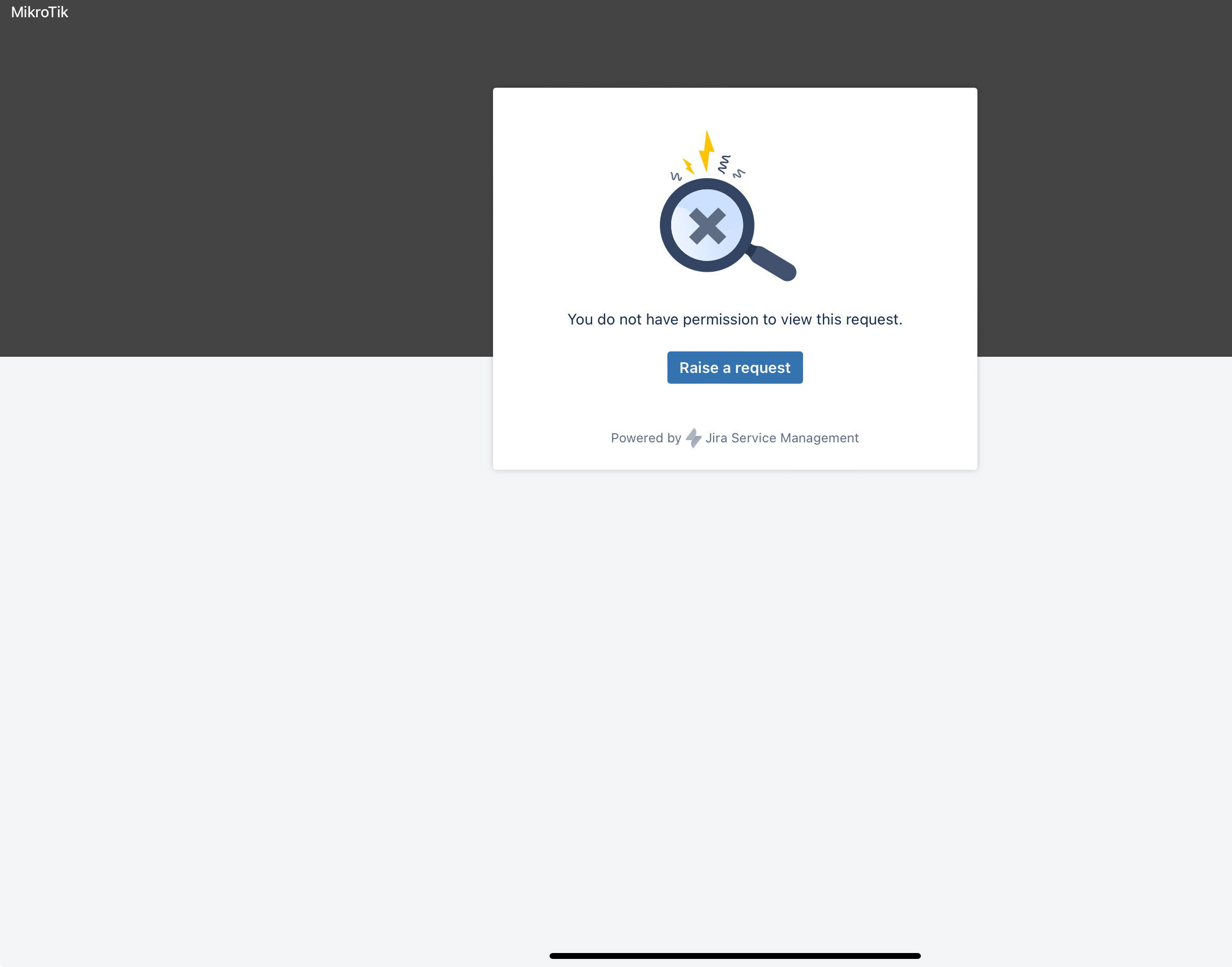

https://help.mikrotik.com/servicedesk/servicedesk/customer/portal/1/SUP-133058
Thank you for sharing the link. But it shows me bellow permission error.

ahh, I guess the bug reports aren’t publicly visible…

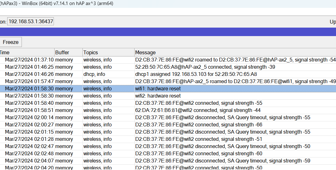

Hi All,
I have the same problem.
Wifi interfaces reset and wifi1(5Ghz) stay on DFS scanning.
Thtanks
Yes, this happening also on hAP ax2 (v7.13.5). Usually once per month.
Today I found this problem also in the logs

I’m experiencing similar behaviour since last week, but I don’t think its caused by Apple device. I’m suspecting my HP Elitebook G9 causing it. Do you know if support is investigating what’s going on? And do you have any idea how to understand what exactly is going on? For now I’m trying to use 2.4GHz interface as workaround
There are quite a few posts on SA Query Timeout. Getting same myself with my Lenovo laptop with Realtek NIC and hAP ax2.
