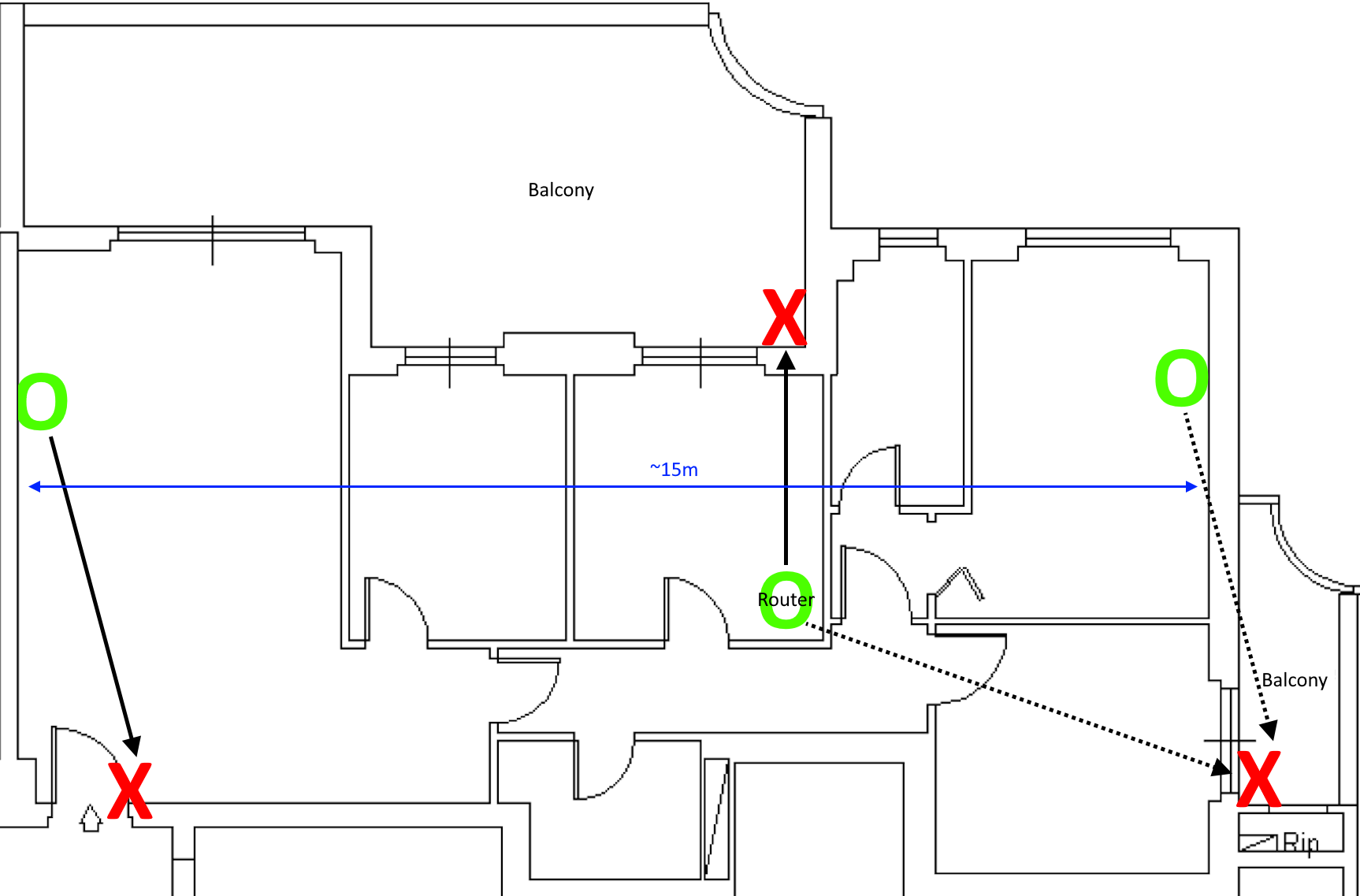

I’m a proud owner of Mikrotik stuff (RB5009 + CRS309 at the moment) and would like to implement my network to try solving some issues I have with other brand equipments.
I’ll attach my house scheme at the end so it would be easy to understand what I need.

Now, if you look at the house map, I placed a green “O” where there is an access point and a red “X” where I have critical wifi devices. They need absolutely the stablest signal as possible. The one that actually have the worst signal, but still enough to work without issues is the one on the right balcony. It usually connects to one of the two APs that are approximately equidistant (dotted arrows).
My first thought was to simply substitute the three APs with 3 others but, given that I don’t produce money :laughing: , I would like to understand if I can save something reducing the number of APs without losing wifi coverage.

Looks like a pretty small area to cover. Depending on you bandwidth needs and expectations this could be covered by a single AP as well. Depends on the walls (brick, drywall,…).
How is the signal from the middle X, to the O to the right of it/ (If you turn middle O off)
I would start with one CAPAX in the current middle position and see if the service is adequate at all locations.
If not, then consider moving the central one to the far right hand position and get a second capax for the left hand position.
(assumes you can wire to all three positions)

Does the cAP ax has good “radial” performances? I saw some picture of the interior and seems it has four 45° angled antennas. I can’t imagine how the signal propagates from it
Then I would start with two capaXs on the outer positions and see if that satisfies the requirements.
How do you suggest to position them? on the ceiling? vertically on a wall or maybe on a shelf facing upward?
If there is possibility mount them on the ceiling.
It is not clear at all (at least to me) which “shape” is the coverage of a cap Ax, I have found an old post stating that the older cap (I think it was about the cap XL) that has the similar 4 small antennas had an almost spherical coverage (as opposed to the doughnut like shape of a common omni antenna).
If this is the case there shouldn’t be that much of a difference between ceiling vs. high on the wall, it all depends on how much work it is to extend the ethernet cable to get to the devices, but in any case signal on the back side of the device (besides there being a wall or ceiling) should be by design 0 or next to 0.
So, for the “left side” cap AX, the 0 signal on the left won’t be a problem, for the right side it would mean that the X spot in the small balcony will remain as is or get worse.
For the (hypothetical) middle one the ceiling mount is instead needed.
But (no idea how well or bad your current AP’s perform) it seems to me that two (or three) cap AX’s are overkill for the size of the house and the placement as in the drawing is “unfortunate”.
According to the Mikrotik (as always rather scarce) documentation the cap AX should be in the center of a room (without intermediate walls) and then it will cover a very large area.
The corresponding placement on your floor plan is the “middle” one and it should be capable - notwithstanding the walls (that seem, at least on the plan, to be internal, thin ones) of covering all the apartment.
About the small balcony on the right, if all that is needed is a connection for the IP camera, I would think of experimenting with any el-cheapo wireless AP/repeaters, the kind that are only a little bigger than a power adapter, plugged in a socket near the area and “dedicated” to the camera only.
Then, I would try with a single cap AX (on the ceiling in the middle position) or if the ceiling is a no-no for any reason, maybe with a little more money an Audience would be a more suitable device.
What remains not well covered is possibly the large “front” balcony.
That might be the real issue, in theory a “directional” AP (with an angle of 90° or 120°) placed on the left side spot would be ideal, but it has to be seen which Mikrotik device would be suitable (and there is anyway WAF possibly involved), otherwise a second cap AX mounted on the wall might do, while still (IMHO) sub-optimal.
In the right side spot, should coverage with the two above AP’s not be sufficient, I would rather experiment with a hap Ax2 (again esthetics and mounting possibilities are relevant here) that might even reach the small right side balcony.
In a nutshell, I would in first instance buy only one cap AX, and test which coverage it has in the three spots, and then proceed based on the results, but before that, I would think whether an Audience would be more suitable (to be placed in the center spot), even if it a bit more expensive it should be easier to place in a non-ceiling position.

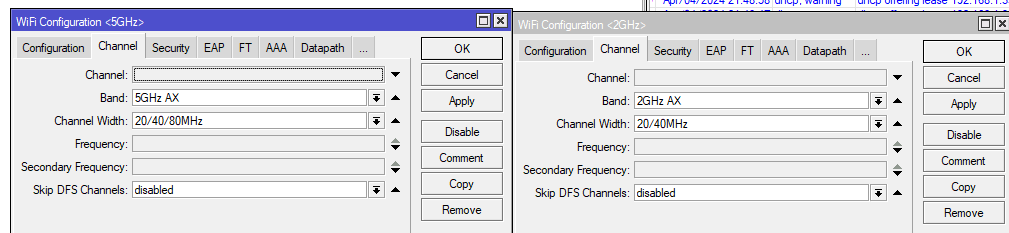

I took one cAP ax and configured it last night, so I have still nothing particular to share with you about the range etc…except the fact that placed near the old AP (they’re still both powered for now) and standing near them, a simple speed test from my phone (in 5GHz) shows bit better results, but as I said before I’m more interested in the widest range possible…so 2.4GHz :smiley:
Now I have a question for the signal-nerds reading: is there something I can configure in the channel settings to squeeze every additional meter from the AP? I did a search and didn’t find nothing that goes deep in the frequency and bands configuration (the official documentations is very concise about aspects that in my opinion would need pages (or hours of video) to explain.
Well, after a couple of days I understood something:
the cAPax placed in the middle room it’s enough but also not :smiley:
5GHz is ok everywhere in the house (mainly thanks to the fact there are only 3 or 4 other AP on that frequencies, so there’s room to find a free slot), near the AP there’s almost no difference with wired devices, in the furthest place i still download at 200/300Mbit.
It’s not the same on 2.4GHz, it’s a bit crowded here, so the signal for the critical devices stays between 60 and 65 dBm but it’s too much subject to the environment. Closing a couple doors or shutting down the roller shutter raise the signal to about 70 or bit more and this seems to be the limit under which it becomes unstable.
And this is what I obtained changing the country from Italy to Panama, which seems to be the one with the strongest Tx power. In fact with wifi analyzer on a tablet placed in the same room of the AP there’s a 10dBm difference between the two countries on the same channel. And in fact using Italy the furthest devices have really instable network.
Now I’m going to try placing the AP in different rooms or different position in the same room to see what happend so maybe I could go with two APs in the two remote rooms.
do you have any suggestion on how to configure the AP?
For the experiments, I would leave settings as they are, to not introduce variations, and fine-tune only once you have a somehow satisfactory setup.
The 5 GHz works fine, so leave it as is for now.
For 2.4 GHz it all depends on which channels are busy/have noise, the generic recommendation of using channels 1, 6 and 11 may be not ideal because of the interferences, at the end of the day the only way to know is trying the various channels, see also:

If you don’t mind me drawing random circles over your house :open_mouth: , if the Cap AX in the left and middle position can cover the area in the bottom drawing (circles of roughly 7.5 m radius) another Cap Ax on the left will cover the rest or viceversa.
If, on the other hand, it is more like the top drawing (circles of roughly 5 m radius) and you will need 3 devices, personally I would buy and try an Ax3 in the middle position, as, if it can deliver something more, you may be able to avoid buying the second Cap Ax for the right side (and if needed use an el-cheapo AP for PtP of only the outdoor camera, you could have also the option (cannot say if possible) to “move” the antenna(s) in other positions using antenna extensions (again if the esthetics in the middle room are not that important) .
If it doesn’t, the right side Cap Ax would cover anyway the right side and again you may be able to play with positioning the Ax3 in the middle in various positions and/or using extension cables and other antennas to attempt to make its coverage less circular and better cover the large balcony at the front.
