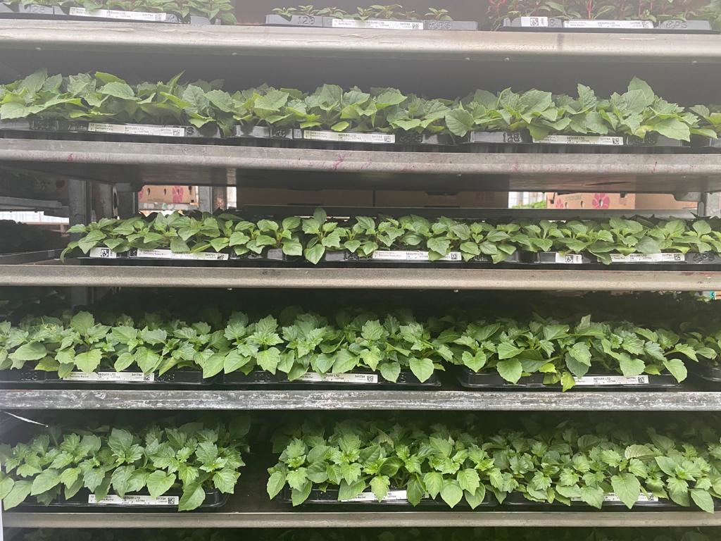

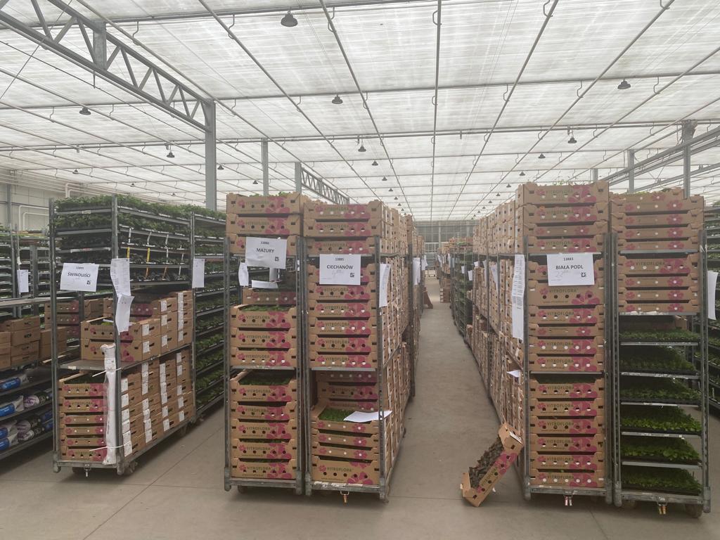

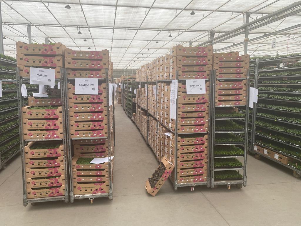

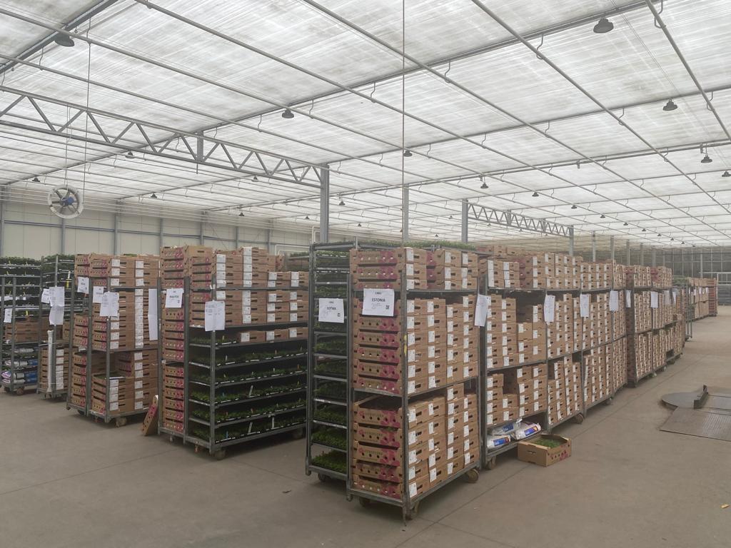

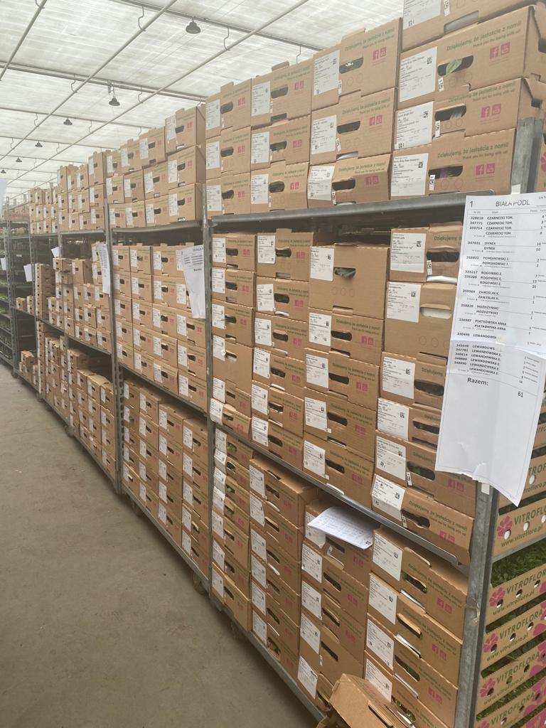

Bellow, I enclose images of how it looks. Packing hall dimensions are 25m x 100m

I have tried building network with 3 CAPac devices. If the packing hall is empty it works. Maybe not ideal but works - some scanners have problems while migrating between APs.
But we need to scan datamatrix codes (similar to QR codes) from carton boxes on CC trolleys. These trolleys are a standard in horticulture - like EUR-pallets (so they can’t be changed). The main problem is that trolleys and shelves on it have metal construction which disturb WiFi waves.
Now we have those 3 CAPac mounted on hall construction above trolleys. Scanning from the highest shelves is OK, but going down starts the problem. If the AP is above the alley where you are scanning it works much better. So in my opinion signal is blocked by the metal construction of trolleys.

  • Moving those APs around eg. mounting them on walls probably nothing changes - only the first alley from AP will be OK, next will be blocked by trolleys. Even if waves go horizontally, parallel to shelves, they will be blocked by the content of those shelves (plants in pots with soil).
  • Making a static layout of trolleys and alleys, then for each alley some narrow sector AP, mounting them on a wall. What about interference between each AP? There will be around 12 alleys so it will be 12 AP. Which AP or antenna can you recommend?
