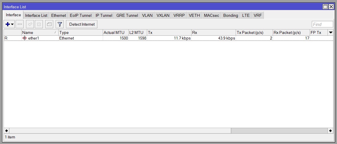

I got a Metal 2SHPn which was working fine before i powered it off about 3 months agoe.
When i powered it up again (without changing anything on the hardware) today, i noticed that the WiFi interface is missing!
Tried several things to get it back… reboot, firmware upgrade to 7.6, reset to default config etc… nothing brang back the WiFi interface.
