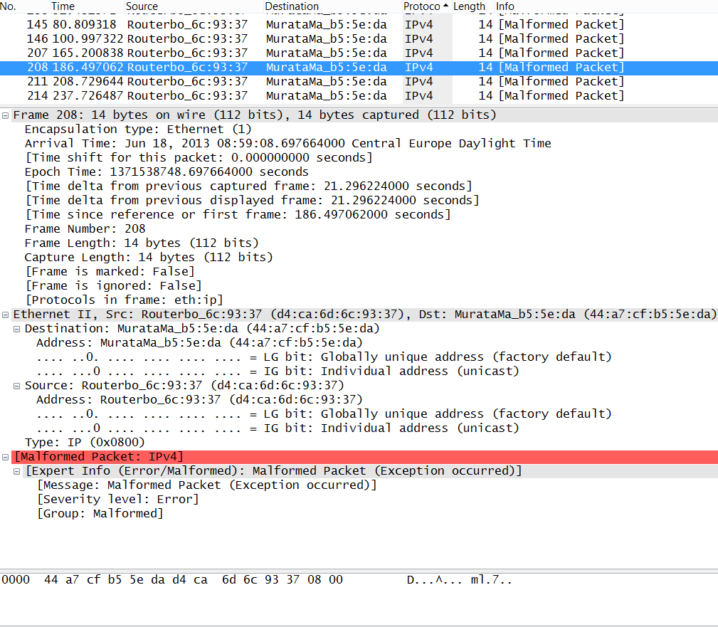

I ran tcpdump on a Android device and can see that every 20-30 seconds there are “empty” packets sent from the Mikrotik to the device and cause wakelocks. The only information in these IPv4 packets seems to be source and destination MAC address.
Constant packets. Mikrotik MAC = d4:ca:, device MAC = 88:30:.
Full info of packet:
When running the tool “Packet sniffer” inside WinBox simultaneously on the wifi interface these packets are not recorded.
Note that there are 5 seconds offset.
What are these packets? Some kind of keepalive? Can I disable them to stop my devices from draining battery?

Attached screenshot of my quick capture.

Currently it is not possible to disable those packets.
Also currently we support only legacy power-saving and WMM Powersaving support will be added some time later.
I got this information from Uldis also for those interested:
“… those are wireless keepalive messages and it is not possible to disable.”
“… we have added this feature in the to-do list, we will try to add in in one of the RouterOS releases as an option.”
