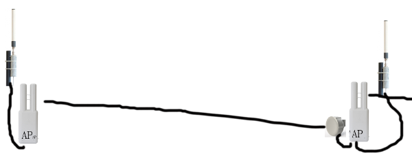

Try something like this.
I give you a advice don’t work with omnidirectional antennas but with sector antennas.
All five on the same frequency? I would not recommend it. Use one fequency for distribution and other for clients. At least. In case you have 50 customers you should have some money for investment. Then go by the way as suggested plisken or so. I would modify it a bit. Connect all local APs directly to main point as much as possible, try not to use wds.
Sent from Android by Tapatalk.
I definitely wouldn’t recommend wds.
Build a backbone with the point to point links. Use BGP routing ore OSPF
All access points have the same ssid but must use different frequencies
