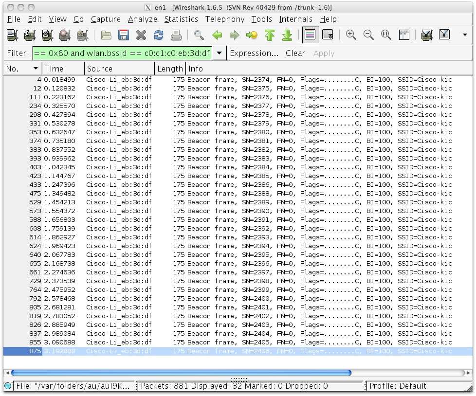

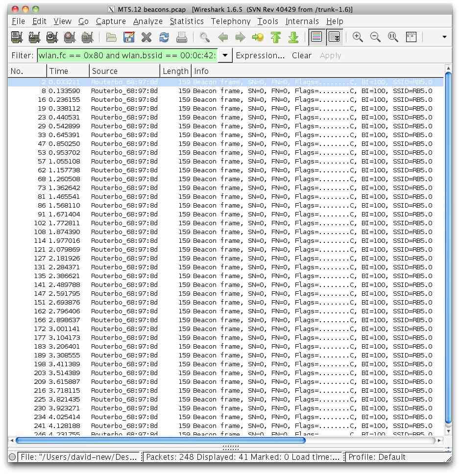

As promised, here are the Wireshark packet captures for Cisco beacon frames and Mikrotik beacon frames.
The Beacon Frame sequence number is identified by “SN=” in the Wireshark capture.
Note that Cisco beacons (as well as Netgear, Airport, D-link, and Belkin) have sequence numbers as required by 802.11, while Mikrotik beacons(ROS 5.12 in this test) have zero where the sequence number should be.
This should be easy for others to reproduce. I can’t prove (yet) that this is causing my problems with iPhone multicast reception, but it appears to be an 802.11 protocol violation. I would welcome the opinion of others and of course the test results of others.
Cisco:
Mikrotik:
