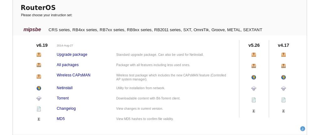

I want to upgred it but i don’t undesrtand what is on Mikrotik website.
What is 6.19? What is 5.26? What is 4.17?

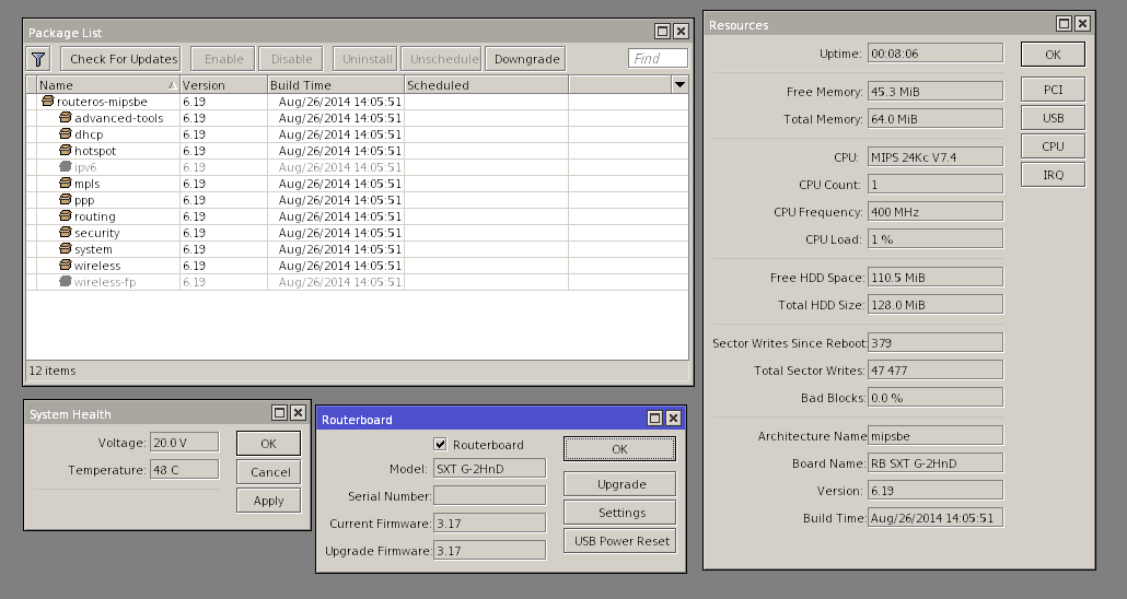

My SXTG2HnD webfig version is 5.26
My SXTG2HnD routerboard Current Firmware is 3.09
My question is “do i have the latest packages/firmware?”
Health:
Voltage 20.0 V
Temperature 47 C
The UTP cable is 20m long.

Download 6.19 and put only selected packages you want by drag and drop into winbox. Then reboot. It will install automatically. Maybe other reboot will be necessary.
I manage somehow to upgrade it to 6.19 with 3.17.
Voltage is 20
Temperature 48.
Same cable cat5e 20m.
Now is randomly rebooting every 10-15 minutes.. from 2-3 minutes :slight_smile: there is a progress
In those 10-15 min there is no fluctuation in the voltage
Any ideeas?

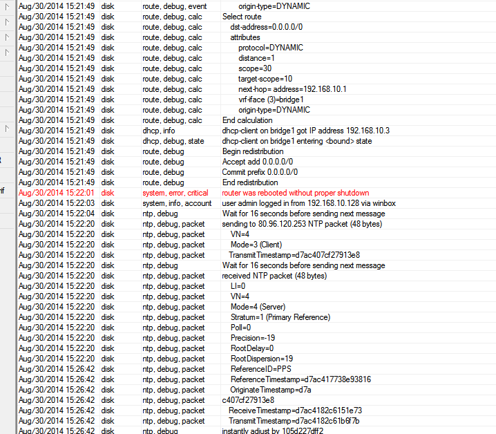

What log says?
If not needed, remove hotspot, mpls , routing, pop packages.
Oh. You installed combined package. I am not using that, recommend to use single selected only packages instead combined one.

Ok,
What is that? Combined packages :slight_smile:
maybe i am a beginner, but the website is not very clear about it. just downloaded that “Upgrade package” and installed.
I have a RB2011UiAS-2HnD that working fine with all the packages.. i will disable those one suggested by jarda
These are the logs.
