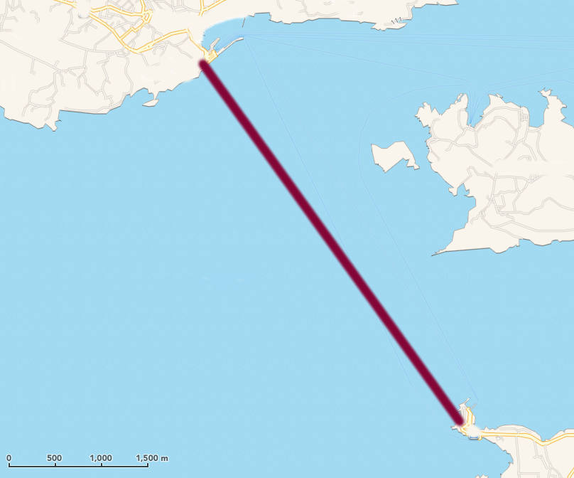

Can you describe (map would be best) the route that the ferries take?

Just as an example, if you’re putting it at a terminal and the ferry goes only straight away from it and back towards it, it’s a lot different than a ferry that weaves through islands and whatnot. Depending on what they use for navigational/safety/etc equipment, the frequency you choose (or have chosen) might be different than we would expect.

It is estimated that the ship mounting height for the CPE antenna will be from 13 - 18 meters above sea level. It is possible to mount AP antennas on the shore at this height also. The general climate is Mediterranean and apart from occasional storm fronts the weather is pretty stable. Wave heights are nominally less than 1 meter. Atmospheric ducting may be present in the summer months but their effects would more likely occur for greater antenna mounting heights. It is expected to use the unlicensed 5Ghz band.
The ferry would be normally tracking back and forth as shown in attached image. The are no permanent obstacles in the signal path apart maybe by the occasional presence of other vessels crossing the ferries path.
It is expected up time will be in the high 90’s %. The multi-path issues with sea reflections may be more of an issue regarding signal strength along the ferries travel path in terms of fluctuating nodes of receive power.

Regarding the wave height, hull design, etc, do you know how the maximum pitch/roll/yaw you will be working with when you’re trying to maintain a strong signal? The path looks like it should be fairly workable. Would you be mounting radios at one terminal or both? (I am assuming you won’t have access to the island mid-way).
I would wager you are looking at lower gain antenna’s at both your terminals and on the ferries to deal with the potential differences in the path due to obstacles/weather/drift and more importantly due to the pitch/roll/yaw. I would guess you are looking at having a pair of access points at each terminal: one for when they are maneuvering and approaching the berth, the second higher gain for when they are mid transit. Then I would connect both sides with a separate wireless backhaul (unless you have another line you can use) then you can join them together and act as one big happy wireless network and start vlan’ing/etc off for your management/whatnot. Whether you want to use mesh/HWMP+ or rely on the clients to roam on their own will depend on how you want to configure things and what throughput you’re looking for in the end. The ships will need to know about the expected wind loading for not only the devices you’re adding but also the masts/etc and that may affect the style of antenna and/or radomes.
That setup wouldn’t really have much in the way of redundancy without relying on a much weaker signal, and there wouldn’t be any redundancy on the ferries but that can be added. You may need some decent power filtering/backup on the ferries too, one issue that may go overlooked is when they switch from the on board generators to shore power.
