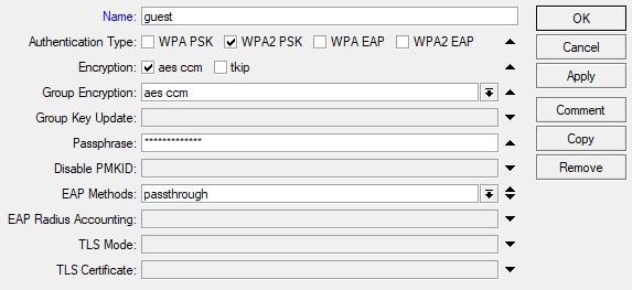

On the old devices, I have only WPA2-PSK + CCMP enabled

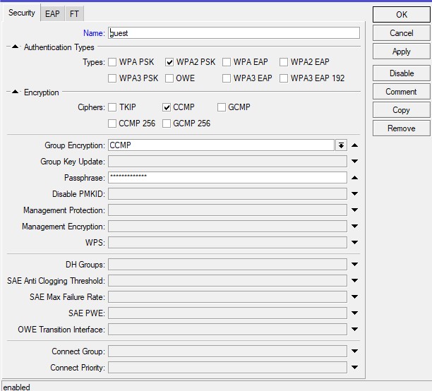

On the new ones, I have the same enabled

CCMP in wifi should be identical to AES CCM on wireless.
But there are other things which might upset your S2, e.g. FT … if I’m not much mistaken, FT is only available for WPA2 and WPA3, but not for old WPA. So do check that FT tab and try to disable it if it’s enabled.
Generally it seems that some wifi devices get upset if AP announces certain features that legacy devices don’t support. They should ignore availability of unknown features (and most do), but some get upset and won’t connect.

Old config:
# 2025-04-01 21:23:01 by RouterOS 7.18.2
# model = RB750Gr3
/caps-man channel
add band=2ghz-g/n control-channel-width=\
    20mhz extension-channel=disabled frequency=2412,2437,2462 name=2g-gn \
    reselect-interval=1w3d save-selected=no skip-dfs-channels=no tx-power=17
/caps-man datapath
add bridge=bridge-nn-guest client-to-client-forwarding=no \
    local-forwarding=no name=datapath-nn-guest
/caps-man security
add authentication-types=wpa2-psk eap-methods=passthrough encryption=aes-ccm \
    group-encryption=aes-ccm name=nn-guest
/caps-man configuration
add channel=2g-gn country="czech republic" datapath=datapath-nn-guest \
    distance=indoors installation=indoor mode=ap name=cfg-nn-guest-2g \
    security=nn-guest ssid=guest
/caps-man manager
set ca-certificate=CAPsMAN-CA-C4xxxxA71 certificate=CAPsMAN-C4xxxxA71 \
    enabled=yes require-peer-certificate=yes
/caps-man manager interface
set [ find default=yes ] forbid=yes
add disabled=no interface=bridge
/caps-man provisioning
add action=create-dynamic-enabled hw-supported-modes=gn,g \
    master-configuration=cfg-nn-guest-2g name-format=identity name-prefix=2G
New config:
# 2025-04-01 21:31:27 by RouterOS 7.18.2
# model = E50UG
/interface wifi datapath
add bridge=bridge-vlan client-isolation=yes disabled=no name=\
    datapath-nn-guest vlan-id=30
/interface wifi security
add authentication-types=wpa2-psk disabled=no encryption=\
    ccmp ft=no ft-over-ds=no group-encryption=ccmp \
    management-encryption=cmac management-protection=allowed name=nn-guest
/interface wifi configuration
add country=Czech datapath=datapath-nn-guest \
    disabled=no mode=ap name=nn-guest security=nn-guest ssid=\
    guest
/interface wifi capsman
set ca-certificate=WiFi-CAPsMAN-CA-Fxxxxxxxx2 certificate=\
    WiFi-CAPsMAN-Fxxxxx2 enabled=yes interfaces=vlan10-lan package-path=\
    "" require-peer-certificate=no upgrade-policy=none
/interface wifi provisioning
add action=create-dynamic-enabled comment="2G AX" disabled=no \
    master-configuration=nn-guest name-format=%I-2G-AX \
    slave-name-format=%m%v supported-bands=2ghz-ax
add action=create-dynamic-enabled comment="2G N" disabled=yes \
    master-configuration=nn-guest name-format=%I-2G-N slave-name-format=%m%v \
    supported-bands=2ghz-n

Set management protection to disabled
