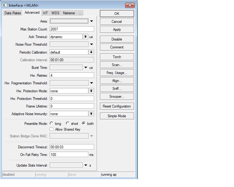

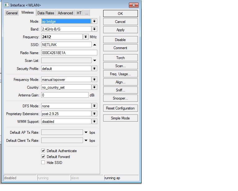

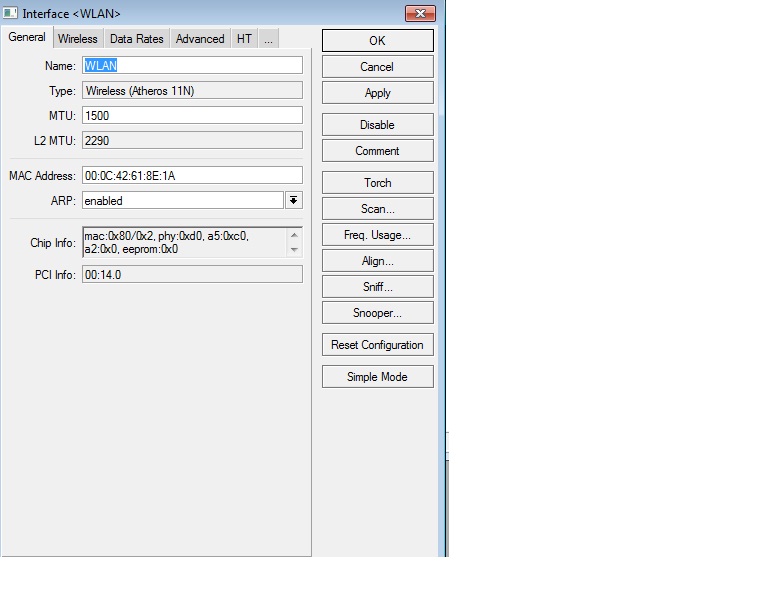

i send the picture of my configuration

i have just use the frequence mode=manuel txpower

  1. Click on Freq. Usage and see the Freq. with lowest Noise Level. Use this freq.
  2. Select Bang to 2.4 GHz-B instead of B/G
  3. Select Hardware Protection Mode to rts/cts and configure the same for your clients.
  4. We are using Hw. Fragmentation threshold = 512 and Hw. Protection threshold = 512. Select what suits u the best in your region. Upgrade Router OS to 4.0 and above.

have u done the settings as suggested. u applied rts/cts and all. ur CCQ shld change immediately with altering from 2.4GHz-B/G to 2.4GHz -B only. If still not changed then check ur Pig tail/or MMCX/ufl connector cable and ur antenna. Send a screenshot of ur client side whr u r reading the CCQ.
