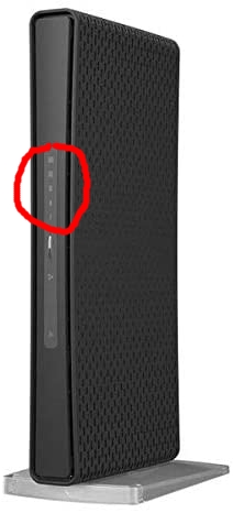

I take this opportunity to ask a question about the LEDs of hAP AC3 and AC3 LTE; what do the 5 leds with cleats indicate? Can they be set to indicate individual ethernet port activity?

you should be able to set the leds in /system leds as follows
[me@ltap5] /system/leds> add leds=cap-led interface=ether1 type=
ap-cap     flash-access  interface-...  modem-technology  on         poe-out                   wireless-status
fan-fault  gps-valid     modem-signal   off               poe-fault  wireless-signal-strength
[me@ltap5] /system/leds> add leds=cap-led interface=ether1 type=interface-
interface-activity  interface-speed      interface-speed-100G  interface-status
interface-receive   interface-speed-25G  interface-speed-1G    interface-transmit
if the menu is empty, you can add LEDs one by one, or even in groups if you need to display something like RSSI.

So are you confirming me that on HAP AC3 - AC3 LTE I can set those LEDs to the ethernet interfaces 1-5? I care that they visualize the activity of the individual ethernet ports is very important to me
i can’t confirm it 100%, but routerOS tends to work so. right now i don’t have access to hap ac3-lte, but i will ask around whether there’s one available for a short test in my area.

You can change LED behavior to show a signal LTE RSRP like that example: LED SIGNAL per RSRP (search : “Final Release” for code)
