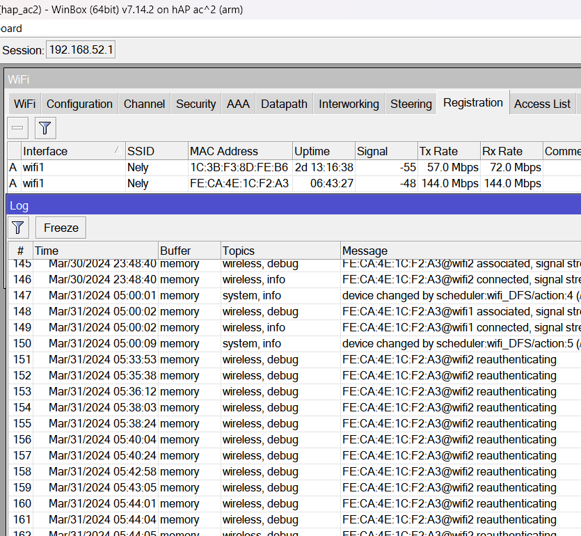

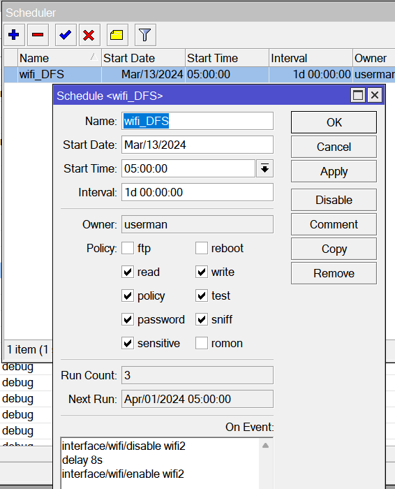

I have a task scheduled at 5:00 that disables and enables a Wi-Fi interface in case it has changed channels due to radar interference. After executing it, I have an iPhone that often cannot connect to it again.

I had wifi reauthenticating loop after upgrading my hap ax^3 to router os 7.15.0 on 2.4 gHz wifi.
  • First I tried to upgrade to latest version (7.15.2) and also upgrade ROUTERBOARD firmware but it didn’t helped
  • Then in system > packages I uninstalled wifi-qcom and uploaded routeros version 7.12.2 with wifi-wave package and clicked on downgrade, after rebooting it was the same. I also downgraded firmware to 7.12.2. I tried to restore a back that I take exactly on version 7.12.2 but still wifi2 and its slave had problems.
  • After that I did a reset factory with plugging in power cable and waiting for LED flushing. It solves the wifi reauthenticating issue and I restored again my backup and it was functional.
    Update (23-08-2024):
  • I faced the issue again after a day. After doing the above instructions again the issue persists and didn’t work anymore but I after removing USB flash drive from the router I accidently saw that the problem resolved. So I can say the root of the issue at least for me was USB flash drive and may be setting up container store and temp folder on that drive.
