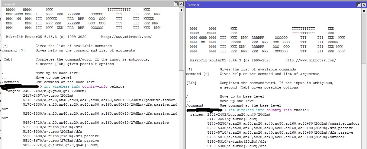

Hello.
There was a problem in the device setup
Can’t set the correct Country
How can it be changed now for Belarus? ![]()
Device: Mikrotik RB4011iGS+5HacQ2HnD-IN
RouterOS: v6.46.3

Solved
Netinstall solved the problem.
Thanks. ![]()
You should buy devices in your region to avoid such problems in the future. The seller has also done some things he shouldn’t have.
