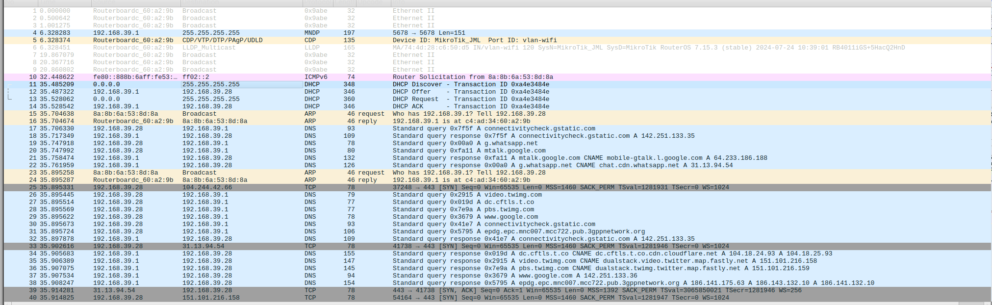

Hi guys, this is my first time posting here, I’ll try to be concise, I’ve managed to setup my mikrotik RB4011iGS+5HacQ2HnD with vlans, qos and basic fwd ( it used to have raw rules filtering bogons and jumps chains on tcp and udp protocols, but for the sake of clarity and simplicity, I removed them).
My problem is when I reboot the router, all vlans but the vlan id 39 (wifi 5.8ghz) offer dhcp successfully. After 3 o 4 attempts with luck then I get an ip through dhcp from any wireless device like my phone or laptop. All previous failed attempts I get “It was not possible get an ip”, in android and apple devices for example.
I switched between qos algoriths like FqCodel and CAKE (with wash and ack filtering) and I even did a sniffing on the bridge and wifi iface trying to understand what’s happening at the negotiation with the dhcp server or if some traffic flow issue was taking place, but I didn’t find anything.
2.4Ghz wlan iface is not enable but works just fine with the same vlan config as the wlan 5.8ghz iface. All address-lists were disabled and tried to only use LAN interface lists when firewalling.
I hope you can help me pinpoint what might be wrong here.
Thanks in advance.

  1. Keep bridge simple aka ONLY need to turn vlan-filtering on! AND ONE BRIDGE!!
  2. Remove vlans from wifi, use wifi for only wifi settings.
  3. Fix /interface bridge ports
  4. Fix /interface bridge vlans
  5. Fix /interface list members
  6. SECURITY ISSUE, never have winbox open to the internet, you have VPNs, use them to access the router, then winbox from inside.
  7. BAD RULE. Too open ended ( always have a clear originator and a CLEAR defined receiver ). Allows all vlans to see each other. :frowning:
  8. I have no clue as to what you are doing in mangles…
    I get that you are trying to identify traffic for queues in some respects, but then you have others that look like forcing DNS traffic???
    Please explain what the purpose of all mangles are for…in words, so that perhaps we can find a better or clearer way.
    Also, just except ICMP in the input chain, and dont try to get fancy with it. WASTE of time.
  9. Remove raw firewall rules. Not needed.
  10. Dstnat port forwarding is incorrectly formatted, if only external access then ensure you put in-interface-list=WAN as an additional component.
  11. Recommend not enabling uPNP if not required.
  12. NTP setup is screwy, you need to setup NTP client Router to internet and then the NTP server to devices on the network…
  13. Dont see any routes???

Ok, most of the notes you made are on features that are not enabled, leftovers of old tests that I ran. (DoH, UPnP)
I’ve appended the fwd rule to block intervlan traffic.
I know the severity about the incoming fwd rule to allow winbox, I just disabled ovpn that I normally use when I need to access from outside (rare occasions) and I forgot to erase that rule by the time I did the export.
Mangle rules are use to apply QOS with FqCodel, that works fine mitigating bufferbloat, that’s a A+ calification for streaming and gaming with a 300/30 Mbits uplink connection.
It’s meant to deal with several devices like smart tvs, cellphones and laptops working at home at the same time.
Anyway, I think I’ve corrected most of the mentions you did, and the problem still remains. All devices stuck at “Connecting”, the first 3 o 4 attempts.
pwd. why can’t I use the vlan logical iface with wifi and benefit from the vlan-filtering ? My router doesn’t support vlans on switch chips.
thanks.
