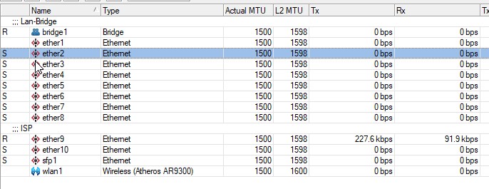

Before the upgrade, the router worked normally (including Wi-Fi). However, after the factory reset and upgrade, the Wi-Fi interface appears in the interface list but does not show the “R” status or any operational information, as seen in this screenshot:

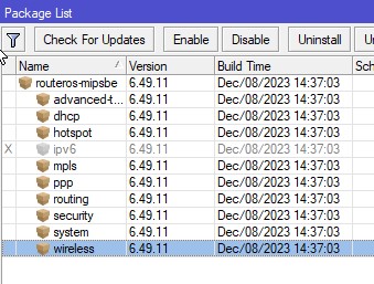

The upgrade required three steps to reach the latest version, and I unfortunately did not record the working version beforehand. I also tried reverting to the oldest available version on mikrotik.com, but the Wi-Fi interface still behaves the same way:

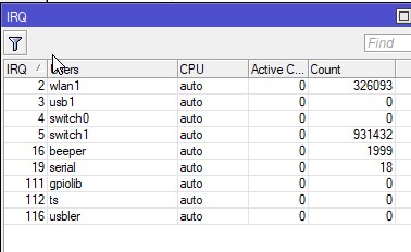

Under Resources → PCI, nothing appears in the device list, but wlan1 does show up under IRQ:

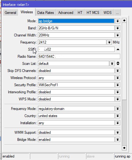

Here is the current wlan1 configuration:

wireless interface shows “R” status only if there’s at least one wireless client (station) connected to it.
Are you saying that SSID is actually not broadcasted? This is best verified by using some kind of wireless debugging application on wireless client (there are plenty of usable apps for smart phones).
You can get some stats by double-clicking wireless interface (wifi1) and selecting “Status” tab … it should show actually used channel and Tx power and some more information. Having empty values for “Registered Clients” and “Authenticated Clients” can be fine … it indicates that no wireless clients are connected.
You were correct!
The router is located in remote location and I don’t have access to client with WIFI there until I asked someone to try. I was expecting the camera and security device will connect back to it since I used the same SSID and Key but eventually I was wrong.
Thank you!
