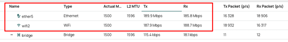

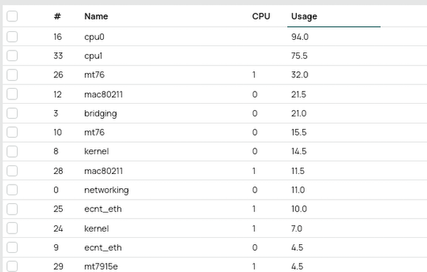

But what worries me is the cpu usage during the test: CPU is pegged at basically 100%. Usage drops to 0% when traffic stops flowing.
On the interfaces listing, all traffic is flowing directly from the wan port to the wireless interface, with barely any traffic on the bridge.
I don't know if this is supposed to happen, but it's weird as i'd expect the bridge to carry the sum of the packets flowing through all the ports that are in it.

I checked your CPU load on my wAP ax (2 cores @ 800 MHz), sampling
/system/resource/cpu once per second during the transfers:
  • idle: ~3%
  • internet download, stalled at 162-183 Mbit: peak 66% / 57% per core
  • LAN download over the same AP-TX air path at 351 Mbit: peak 58%
So at least on my hardware the stall is not CPU: no core gets anywhere near
100%, and the transfer that runs 2x faster actually uses slightly less CPU.
Your 100% peg may be a real ceiling of the ~480 Mbit aggregate your --bidir
test pushes, but that looks like a separate effect from the low-rate stall —
worth re-testing each direction separately, since --bidir on WiFi makes the
two flows fight for airtime and inflates retransmits on its own.

  • The "barely any traffic on the bridge" observation is expected, not a fault:
    the bridge interface counter only counts traffic to/from the CPU (L3) port;
    L2-forwarded traffic between ports shows up only on the port counters.

Done more tests.
Speed test / Bandwidth test, TCP+UDP between Router <-> AP (cable) = full 940mbit symmetric, except when doing both directions simultaneouslt, in that case the limit is CPU on AP (but BW is still ~800mbit on both directions).
Test between AP and my computer. I used btest-rs on my laptop to run a Mikrotik-compatible server ( https://git.manko.yoga/manawenuz/btest-rs/ ).
Results (as seen from the AP)
TCP Download: 335Mbps local-cpu-load:85%
TCP Upload: 54.2Mbps local-cpu-load:90% remote-cpu-load:6%
UDP Download: 54.9Mbps local-cpu-load:7% remote-cpu-load:6%
UDP Upload: 421Mbps local-cpu-load:97% remote-cpu-load:11%

Running bandwidth test on MT devices is most often the limiting factor as it consumes lots of CPU power which would otherwise be used (or even required) to process traffic. The only "excuse" for running btest is if one runs a (very beefy) CHR.
Experience is that whenever router/AP CPU load exceeds 50% (give or take, also depends on individual CPU core utilization) its overall performance starts to drop.
It's always recommended to run tests "through" tested devices ... which means on two "normal" computers (where one is actually testing the link in question and one is connected beyond the tested link but with connection which by all means known to admins will not be a bottle neck). In this particular case this means one PC using WiFi connection to AP and another computer connected using wired connection to same AP ... and run iperf3 test between those two computers.
This is the test as seen from the RB5009 router. Path is RB5009 -> Ap AX s -> My laptop
Same exact result.
TCP Download: 541Mbps local-cpu-load:39%
TCP Upload: 36.0Mbps local-cpu-load:33% remote-cpu-load:6%
UDP Download: 73.5Mbps local-cpu-load:19% remote-cpu-load:6%
UDP Upload: 389Mbps local-cpu-load:39% remote-cpu-load:9%
During the test, the hAP cpu usage was still high (although not as high as when the test was running on the AP itself):

Do I understand you correctly that AP-RX means station is trying to push traffic and AP is receiving it (over wireless)? Which would indicate that it's laptop which is behaving weirdly ...
Another thing to consider (and I don't know exactly to go around): in half-duplex shared medium environment (which is what WiFi is), excessive traffic in one direction can very much stall the other direction ... which makes sending ACKs even harder. I.e. if laptop has its Tx buffers full, it may aggressively use airtime (and I'm not sure if AP has any control over how its own stations use it), hence making others (AP as well) to wait for their chance to transmit. This doesn't happen in full-duplex (dedicated medium) as each side can always transmit regardless the traffic in opposite direction.
Which is why one has to set limits on queues (which are supposed to throttle traffic in Rx direction) slightly lower than expected maximum speed ... to accommodate any overhead and ACKs are kind of overhead with regard to application payload.
Seems that mediatek WiFi driver (mt76*, mt7915e and mac80211 combined) used quite big proportion of CPU ... which is to be expected as all traffic to/from WiFi interface(s) is handled by CPU (on all MT devices regardless the architecture, chipset and driver used). So it is what it is.

btw, i'm not suffering from the CPU load issues @unfoxo is reporting, i think his issue, although
it looks the same, is different when looking closer.
