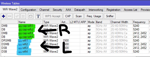

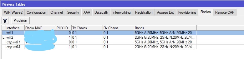

I tried local radios work on capsman. First select manager=local and you need one time provisioning local radio on radio window and radio stuck on local managed mod :smiley:

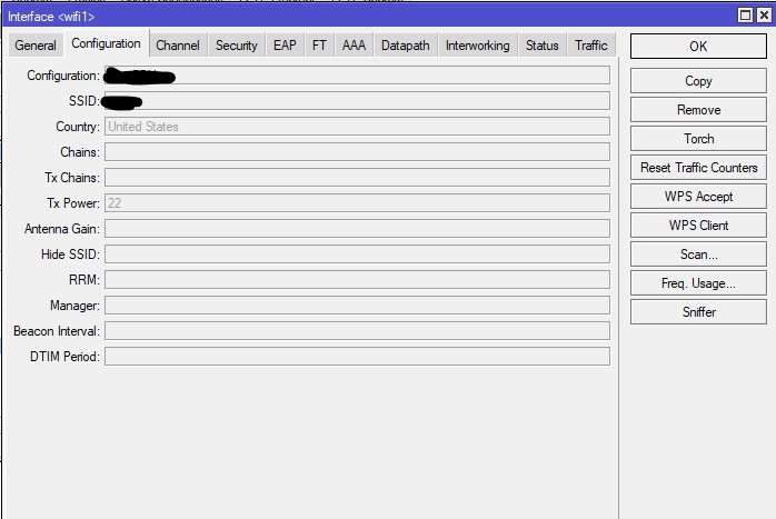

Local and remote cap works on same provision rule and configuration. I using now like this. Local radios need only bridge rule.

edit: 17db txrate: my fault. I was selecy two different country
bridge port created automaticly when interface “R”
