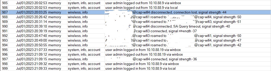

I enabled FT and FT over DS options but how to know if clients are actually roaming between two APs ?
EDIT: I presume this log means it’s working :smiley:
At what signal level devices roams to another AP ? I went upstairs and my phone remained connected to downstairs AP, signal level was -63, i disable and enable wifi and then phone connected to upstairs AP
So my wife’s phone roams without problem but my doesn’t want to roam for some reason, i can see for eg that signal gets low, about -87, then i get SA query timeout and phone reconnects to another AP.
It’s working now, every device I tested for now roams without a problem.
