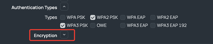

After changing wifi device to mikrotik I set the same SSID on it and have the same issue with part of tuya devices… It seems tuya remember associated MAC for that SSID or so… just change the SSID on mikrotik to the new one fix the issue with my tuya devices. But all of them should be reregistered.
Hi. I just removed the options item. Encryption=ccmp,gcmp,ccmp-256,gcmp-256. for 2.4GHz. I had this problem on 2.4GHz. I am using the RouterOS version 7.19.2. (hAP ax²)
