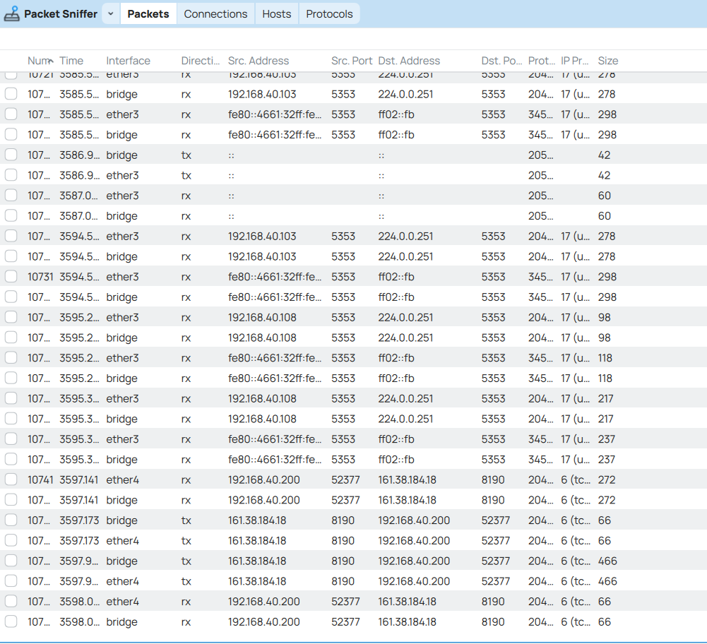

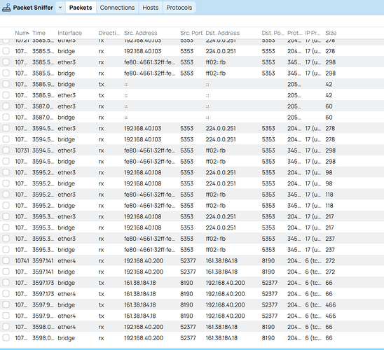

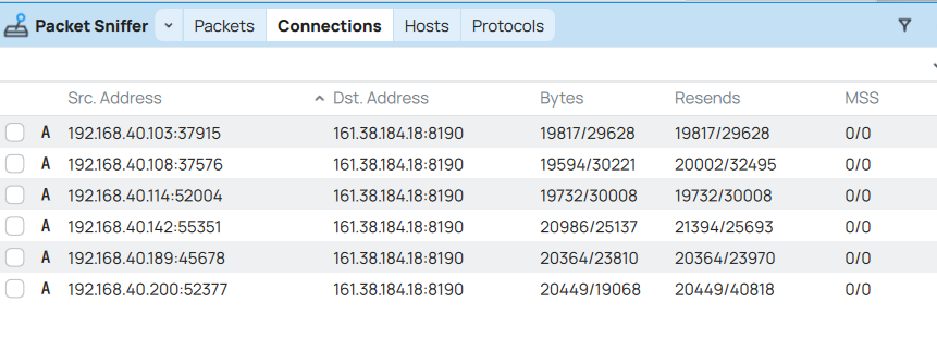

I looked at the saved sniffed file, but it is not in ASCII.
Here are some screenshots of the sniff:
The modus operandi of most of these IoT devices is the same - they establish a single TLS connection to one server from a pool in cloud and internally use this connection for all sorts of communication. I don’t say it is not possible for them to temporarily establish some other connection ad hoc for a software upgrade, but if you experience the communication loss frequently, I don’t think it is related to software upgrades - I don’t think the is enough software complexity in a thermostat that it would require an improvement every other day. And if it does, I’d be afraid to use it.
