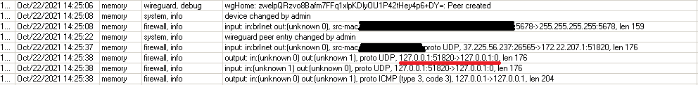

Will NATted wireguard work?
I am trying to run local wireguard server using Mikrotik though its implementation (7.1rc4) does not respond to Android Wireguard client implementation (1.0.20210926).
The config of server and client are inside attachments. In simple words: Mikrotik Wireguard does not respond, though routing IP configuration is correct and simple ping does work (I cannot ping phone IP as phone ISP provider is NATted).
I suspect that Mikrotik is confused where to send back wireguard packets and just silently drops them.
I wonder why: for me it’s clear: send back where you’ve got them (same IP, src port). I also tried to remove Listening port in wireguard client, it does not help.
Are there any more logging filtering rules I can apply to see what’s going on inside WG?

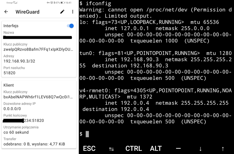

For SMART PHONE Wireguard Settings
Public Key = yyyyy The public key provided TO the server router
Addresses = 10.10.10.2/32 The address assigned to the iphone for the wireguard traffic.
For SMART PHONE Peer Settings
Public Key = xxxxx The public key provided BY the server router.
Endpoint = IP CLOUDname:9213 the name of the server router appended with listening port. ( tells the smartphone where to make the initial connection)
Allowed IPs = 0.0.0.0/0 ( which basically lets any IP assigned to the smartphone be relevant either assigned by coffee shop wifi or cellular provider etc..)

The problem is that I do not see reason it does not work: packets arriving from Phone to MT and … no reply provided by MT. And this black box keeps silence.
Still have question:

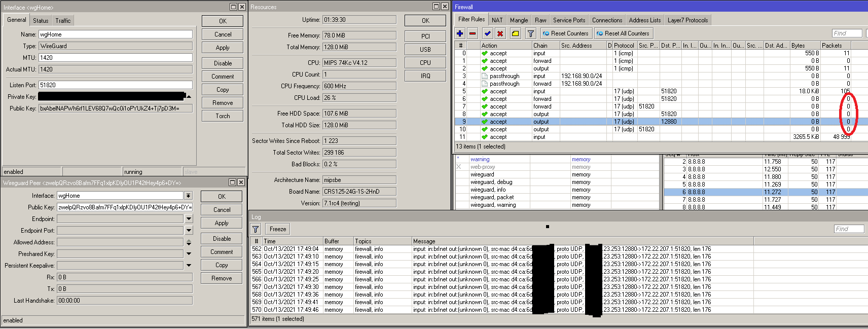

Why is the output chain used and especially for the UDP port.
Just to demonstrate that nothing is generated by WG server. And general question: why not?

The problem is clear: packets are entered into WG server, but no output generated by WG server: neither new packets in output chain nor errors in log.

This was helpful: after adding 0.0.0.0/0 into allowed addresses I am get error in the log. I still don’t get why WG binds to 127.0.0.1.
Also please see export in the attachement.

(5) Lets look at wireguard settings… Assuming this is SERVER router (where the peer clients reside).
First thing for your android phone to work you need the IP Address given to the android phone it the android phones WG settings.
More specifically in the phones OWN WG settings (not the phone peer settings).
So you need to put an address here on the phone that matches up the allowed address on the router.
Lets say on the phone you use 10.0.30.2/32
Listen port not required
I put in DNS servers 1.1.1.1 and 9.9.9.9 as well, not sure what your phone has.
On the phones peer settings this is where you put the endpoint of the router.
I use the IP Cloud address of my router for this
I dont use keep alive
Its in the peer settings you put allowed IPs 0.0.0.0/0 (because we dont know what public IP your phone will have when you connect).
So now looking below, in the red on your router is where you would put 10.0.30.2.
The other two lines, not sure what they are for but remove them for now as they dont seem to server any purpose.

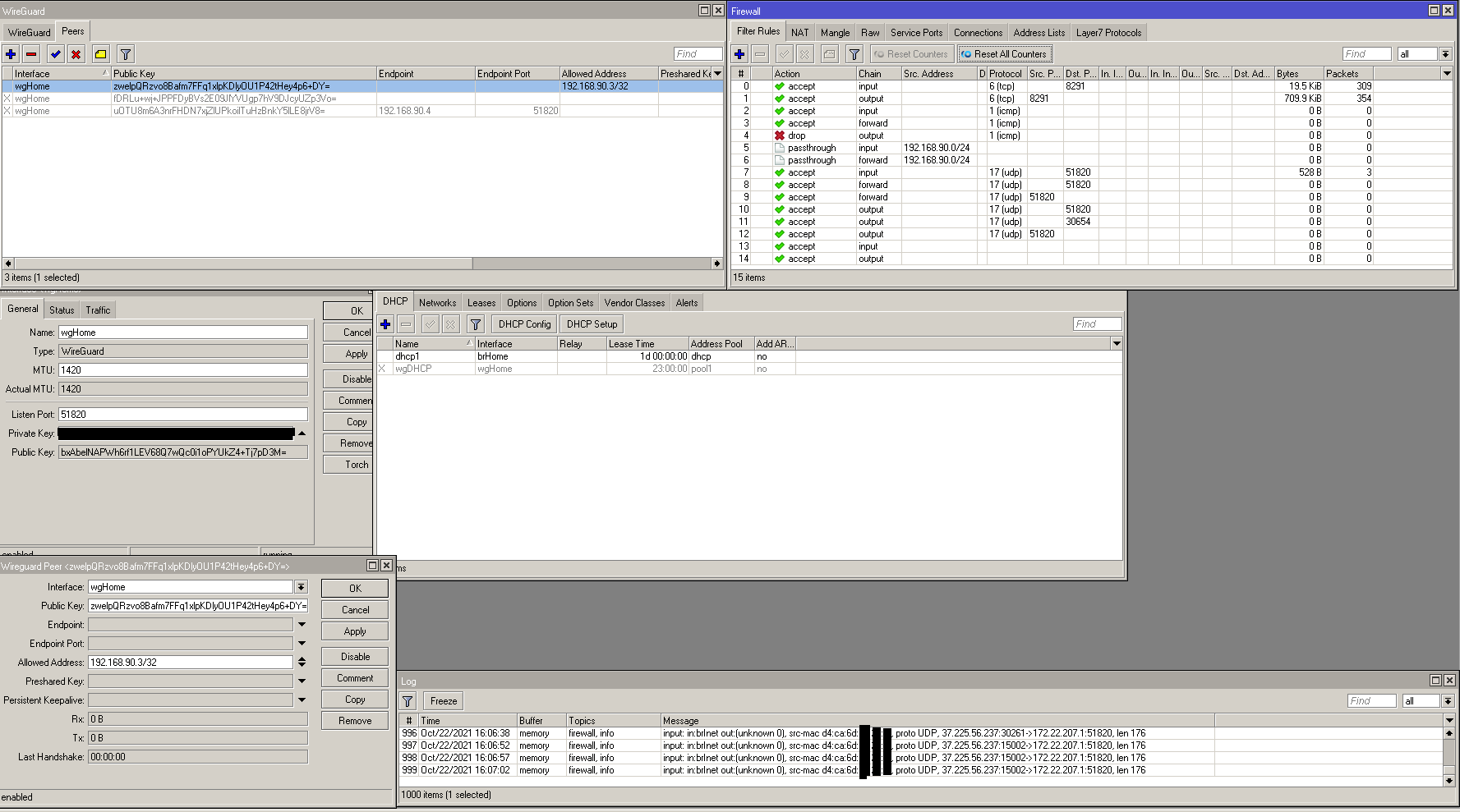

Tried to specify 192.168.90.3 on MT in peer “Allowed Addresses” field: WireGuard server (Mikrotik) just shuts up, i.e. no responses sent to 51820.

Tried this 192.168.90.3/32 as suggested by holvoetn above: server shuts up.
Something badly screwed in the WG implementation here.
Endpoint == bindpoint?
Allowed addresses works only with 0.0.0.0/0.
Incorrect names in WinBox 3.31 x64. Which one do you use?

Thus my verdict:
WireGuard implementation in Mikrotik RouterOS in 7.1rc4 incorrectly binds to output interface and replies to peers (i.e. clients connections).
Actually it does not know where to bind and binds to 127.0.0.1.
Below is a demonstrating example from post #9.
I dare to say that conclusion is pretty premature.
Some important info is missing which you are not showing and unless I missed it, you have not provided that information, not even after having been requested to do so multiple times.
It was requested first here by anav:
