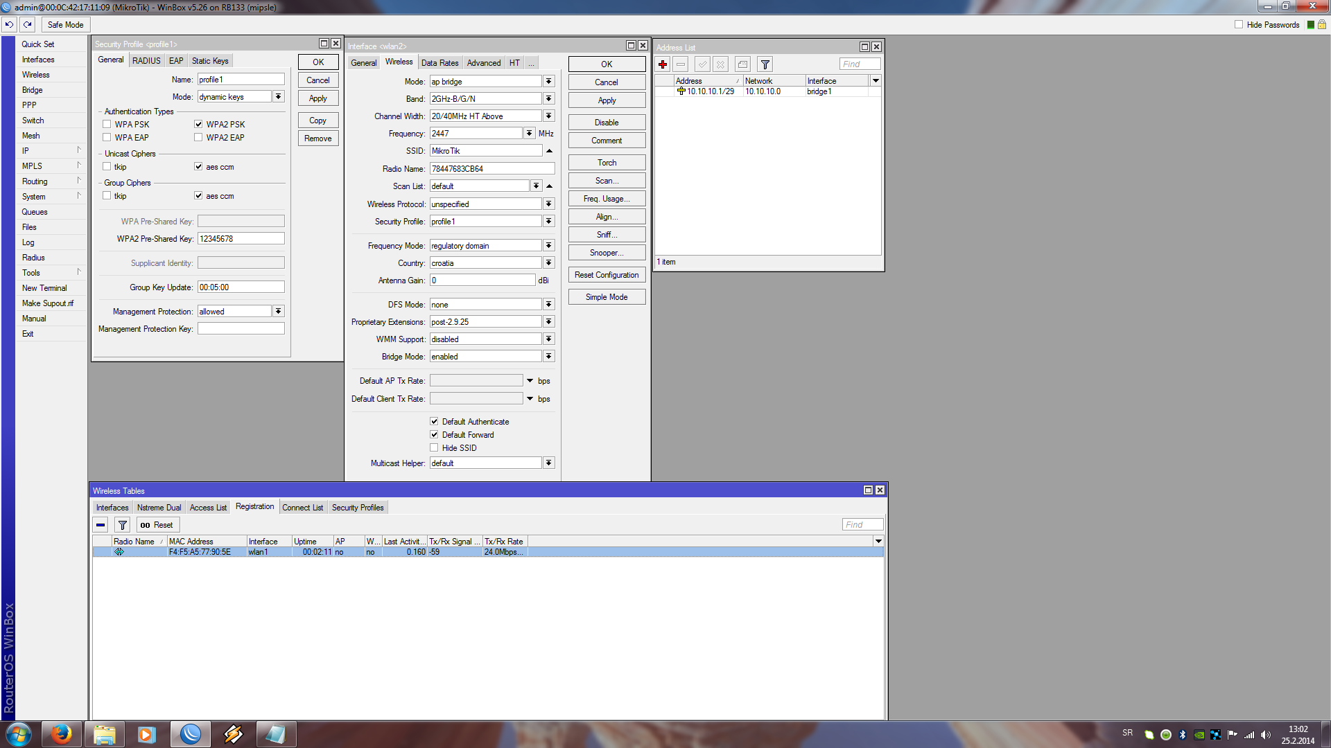

for anyone that have windows phone 8 or windows 8,this solved my problem.There is a security issue in negotiation.I managed radio signal but after that unable to connect.When i changed security profile everything worked just fine.
I have the same issue with Win8.1 x64 using atheros AR9382 with latest drivers from atheros.cz. This notebook cannot connect to my rb2011uas-2hnd-in using the same security profile as in post above. This is a shame as I have no issue connectin to number of other APs, including some other mikrotik APs with WP2-enetriprise at my work. Should this be issue in driver or in windows 8.1, it would surely prevent me from connecting to some other networks as well, so far, the only problem is with RB2011
