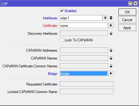

Winbox 3.5 bug?
anyone notice when setting wireless to caps mode you can’t save the settings when the certificate box says none. The word certificate goes red like you’ve set it wrong.
Works fine when you set it via the terminal.

ahh cheers, pretty sure its a winbox bug not a ros bug. Don’t think it was doing it when i was using 3.4 winbox.
It’s doing it on lower ROS than 6.37, i’ve got a haplite i had in my drawer with 6.36 on it that does it.

i had the same issue. and i have sent the mail to support team they said that it is winbox problem and it is fixed in v3.6
however i could not wait and find solution for that.
Although, you want to make CAP and not the manager.
but do this trick and it will work like a charm
go to CAPsMAN and create in interface section click on Manager and for temporary enable the manager and choose the Certificate and CA certificate to auto then you can see that the RED certificate would be gone. then turn off CAPaMAN and do rest of your config.
with this temp solution i could make my 10 WAP work under the capman
