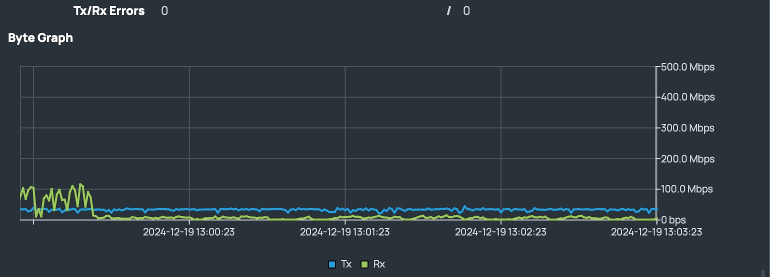

One small suggestion about the scaling of the y-axis of the graph(s). I found the step from 100Mbps to 500Mbps a little too big. My connection is 100Mbps and spikes just going past 100Mbps line are common.When such a spike happens, y-axis scales all the way up to 500 which I think is too high because what I see after that point is not as useful due to loss of precision.

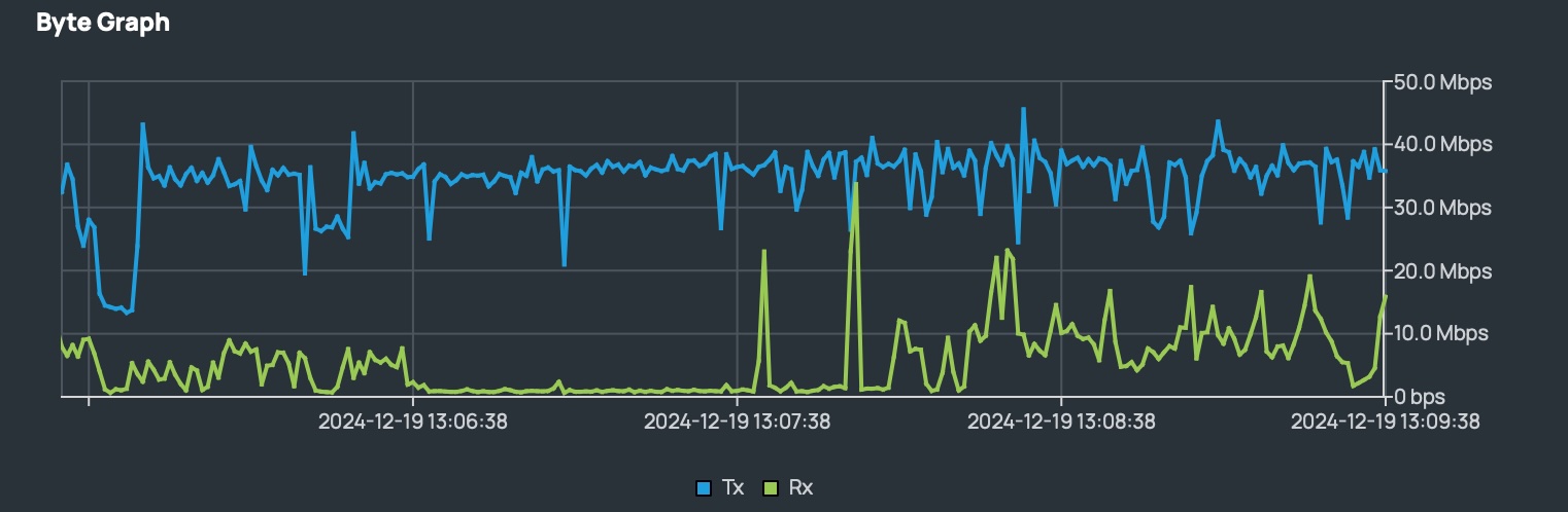

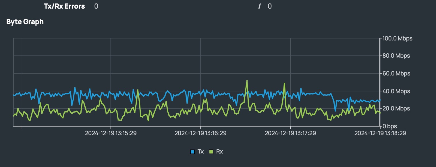

The step from 50Mbps to 100Mbps is just fine and I think 200Mbps could be a better next step.
